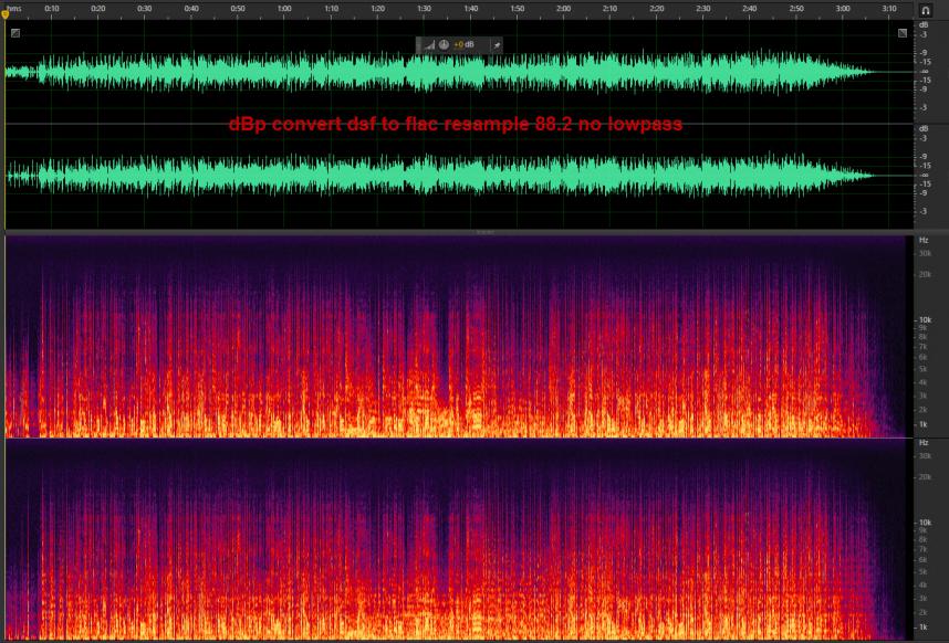

    Here's what the converted file looks like with no Lowpass DSP added:
    http://forum.dbpoweramp.com/images/attach/jpg.gif

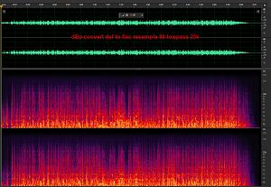

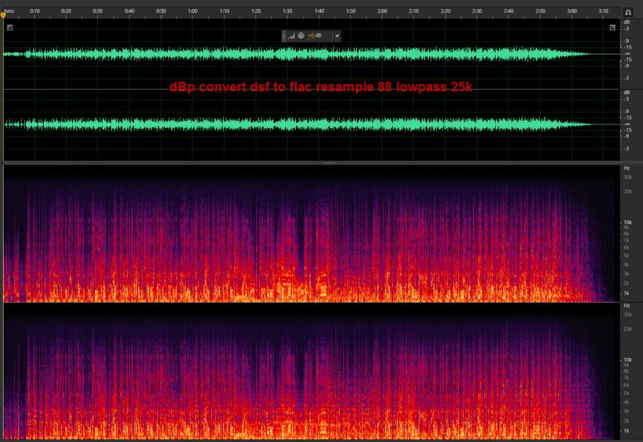

    Here's the same file converted with the Lowpass DSP:

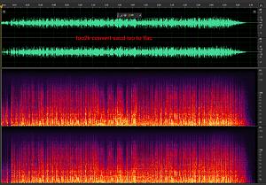

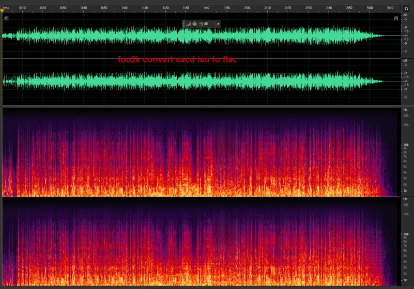

    For reference, here's the same track converted by Foobar2000 with the SACD Plugin:
    Thanks in advance for any help and insight.

      dBpoweramp converted file no lowpass dsp:
      dBpoweramp lowpass dsp added at time of conversion:
      For reference, foobar2000 flac converted from SACD iso image:

        Re: DSP Effects R11
        It is how that filter works, if you do a bit depth set to floating point 32, do the low pass, then volume normalize +6db, then bit depth to 24 bit, you will not lose anything.
