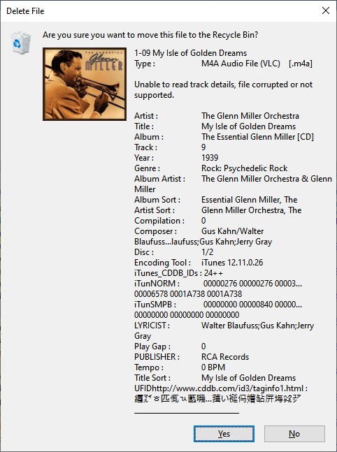

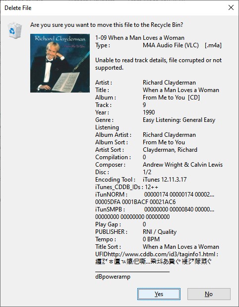

    Ran the Music Converter and the Batch Converter and get a number of these error messages. What I was doing was just using the converter to add DSP (Normalizing the levels) not actually changing the file type.
    When I look at the file properties these are all M4A (AAC) files that were originally "ripped" with iTunes. What is strange is that this is sort of "hit or miss" in that its not the entire disk but an occasional track. See two examples of the properties.
    When I attempt to play the file I get a short burst of high pitch sound and then the cursor just moves through the audio file with no audio.
    I am now going through the process of ripping the original CDs (these were commercial disks, not anything that I made) using dbpoweramp ripper to fix the digital library.
    Two questions: Since these are M4A is there any chance the tags (probably MP3 type) are causing an issue? I don't think its the actual audio but the header that is causing the converter to fail.
    And when I went back through the library with the error list, sure enough each file would not play --- but it did at one time. The player I'm using is MediaMonkey 5 (and iTunes 12.12).

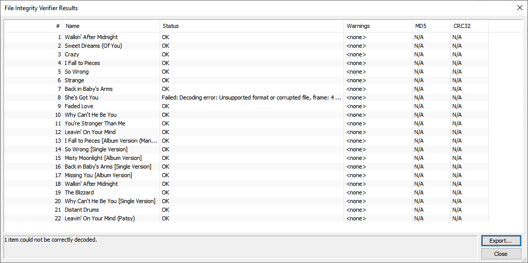

        If you load up foobar2000, and install the "file integrity verifier" component (it may be automatically installed in foobar2000 ver. 2) you can check all your files and get a list of corrupt file. Load up all your files in foobar (just point to top level folder in the foobar library). Then select all files, right click, and select UTILITIES > VERIFY INTEGRITY. It will check every file for corruption. And when done you can export the list of corrupt files it creates for your later use. Good luck.

          Thanks so much! Just loaded foobar2000(and yes, the file integrity verifier was included in the install). Its running through the entire library now. Thanks for that tip!

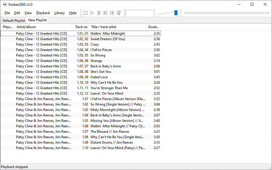

              Here is a test run --- I selected two folders (foobar playlist) and ran the integrity test (foobar integrity)
              The playlist shows the album name but the integrity check only shows the title ---- when I ran my entire library all the titles were there but its hard to match them up with the folder/album.
              When I export the errors, it does show the album --- guess that's ok, since it was still running I didn't see that the export would list the entire path -- now to filter out all the errors and just get a list of the bad files.
              ThanksClick image for larger version

                  The dbpa Test Converter worked great! Now to plow through and rip those files again.
