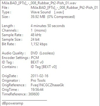

    If I hover the mouse cursor over a file dbpoweramp displays all of the tag data but when I use the "Audio Info" to export to a text file it does not export all of the data, it leaves some of it out.
    This is what dbpoweramp displays when I hover over the file

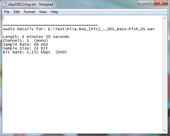

    This is what the [Audio Info] codec exports

      Re: [Audio Info] codec does not export all tag data?
      On the audio info settings page you have to check the box 'extensive audio info'
            Hi Spoon
            That worked great, thanks.
