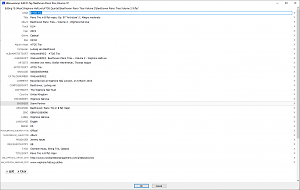

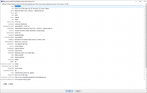

    Looking at the files using dBpoweramp Edit ID-Tag, the files contain a tag 'Disc', which have values of either '01/02' or '02/02', as appropiate. There is no tag in any of the files that equates to the disc numbers detected by my phone. Comparing the metadata of file 10 with that of files 9 and 11, there are no obvious discrepancies (I have attached screenshots of tracks 9 & 10, for reference)
    Any suggestions as to what this value is, and how I can reset/remove it?

    since they are downloads, I'd simply renumber the tracks from 1 to 10, then delete the Disc tags. Also check that album name is identical for all tracks.
      • 43985
      Re: Issue with the Tags on a downloaded FLAC file
      Perhaps it is tagged in a format which the phone is not able to read correctly, but dBpoweramp can.
      If you visit codec central (link on toolbar) >> utility codecs and install 'ID Tag update' then convert this album to that encoder, it will remove the ID tags and rewrite them. Then try on your phone.

        Perfect - Ran all the files through 'ID Tag update' and that has resolved the issue. Thanks for your advice and assistance.
