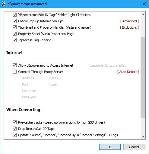

              Re: From 16.3 change log: ID Tag: Option to disable predictive typing
              This is how my two installations look:
                [ATTACH=CONFIG]1884[/ATTACH]
                This is for registered version installations and not trial versions?
                    The option is a dBpoweramp Reference option, if you have the 'Power Pack' it would not show.
                        The power pack version was discontinued over 8 years ago (but is still supported).
                          It appears all I'm missing by having the Power Pack version is PerfectMeta and the options in Configure we've been discussing. All the other features listed for the Reference version work for me.
