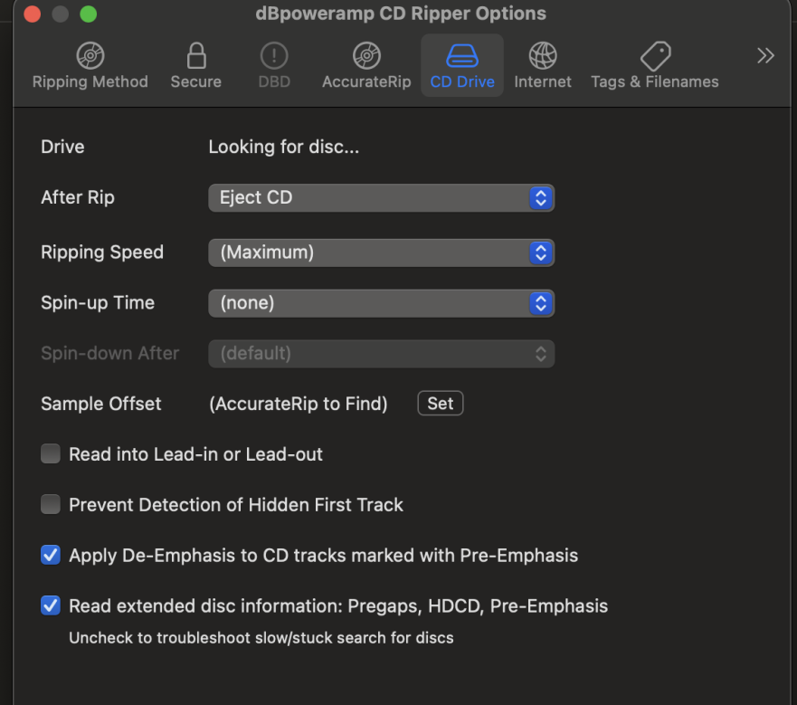

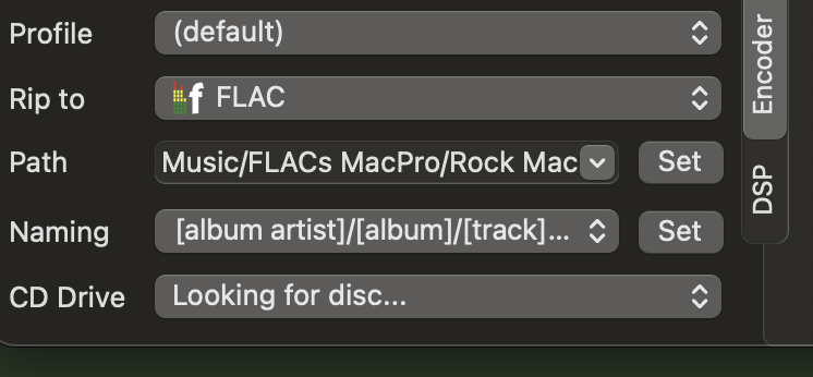

                  My CD drive is fine. I can convert an audio track with it from aiff to m4a. CD ripper just says looking for disk and the CD drive eventually turns off. Click image for larger version  Name:	Screen Shot 2025-09-10 at 7.19.51 PM.png Views:	0 Size:	165.0 KB ID:	335047
