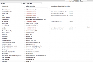

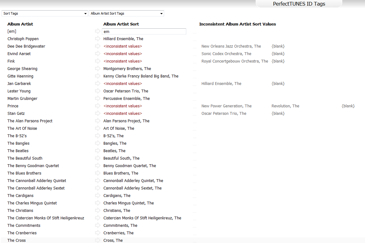

    Hey there,
    maybe I'm too dumb or I'm too smart for this tool but I don't understand how to use PerfectTunes ID Tags in case of inconsistent values.
    Have a look at my attachment to understand the following:
    1.) I.E. I've set "New Power Generation, The" as album sort tag for "The New Power Generation", and "Revolution, The" for "The Revolution".
    2.) The next time I've used PerfectTunes, I saw the hint that there are inconsistent values in combination with "Prince".
    Prince is an album artist in combination with the album artist "The New Power Generation" for one album, as well as in combination with the album artist "The Revolution" for another album.
    So what can I do? What should I do? What does PerfectTunes expect me to do?
    As far as I understand, the tag "Album Artist Sort" can have multiple values. So what I would expect and like to have is, that "Prince; New Power Generation, The" and "Prince; Revolution, The".
    Can I get it by PerfectTunes ID Tags? And how?
    Clicking the arrow just copies the left album artist in the the new album sort artist, but that's not what I want. What shall I type in in the field "<inconsistent values>"? And what is the filed "{blank}" for?

      So from PerfectTunes ID Tags view, I have to:
      a) add a album artist sort tag "Prince" for all "Prince" albums first
      b) then I can add the album artist sort tag "New Power Generation, The" for "The New Power Generation" and "Revolution, The " for "The Revolution"
      Otherwise I would see the situation documented in the screen shot.
      Or is there a different workflow you had in mind, when you designed the program? Is the program and workflow able to fix problems with multiple album artist sort tags at all?

                  I agree with you totally, but that is not the problem. I try to explain it again:
                  Imagine the following situation with just two albums
                  1.) Album named "Album 1", with only one album artist: "The Artist 1"
                  2.) Album named "Album 2", with two album artists: "The Artist 1" and "The Artist 2"
                  No album artist sort tags assigned so far.
                  In the album artist sort tag view of PerfectTunes ID Tags we will see two artists/lines:
                  The Artist 1 ->
                  The Artist 2 ->
                  If I assign a value for "The Artists 2" now like
                  The Artist 1 ->
                  The Artist 2 -> Artist 2, The
                  PerfectTunes will insert a single album artist sort tag in the ID3 tags with the content "Artist 2, The".
                  This leads to the situation, that PerfectTunes will now report an inconsistent value for "The Artist 1", namely:
                  "Artist 2, The" and "{blank}"
                  But "The Artist 1" hasn't been touched at all! And "The Artist 2" has still one album artist sort tag assigned: "Artist 2, The".
                  Got it?
                    • 1934
                    Re: How to use PerfectTunes ID Tags in case of inconsistent values?
                    Hey Spoon,
                    an even simpler example to understand the problem:
                    Imagine the following situation with just one album recorded by two artists "The Artist 1" and "The Artist 2". Both artists are listed in the album artists tag and in the album artist sort tags.
                    The Artist 1 -> The Artist 1
                    The Artist 2 -> The Artist 2
                    If I assign a new value for one of those artists, i.e. "The Artists 2" now like
                    PerfectTunes will substitute the former two album artist sort tags by only one album artist sort tag with the content "Artist 2, The".
                    At the next start of PerfectTunes we will see the follwoing situation:
                    The Artist 1 -> Artist 2, The
                    There is no more an album artist sort tag for Artist 2 listed.
