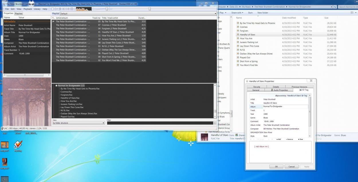

          #34
          Re: Batch conversions of WMA lossless to Flac - preserve tags
          So, it seams like they are out of order in the directory. If I re-order them in Mp3Tag, then it makes me go through the processes of manually aligning the track with the correct title. Moving files up and down a list is a PITA. I've attached a screen capture showing the files open in Windows explorer and also how the display in FooBar.

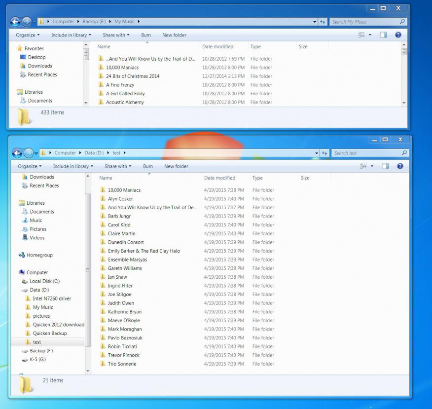

                  #38
                  I just ran a test in Batch Converter using your string. It turned the top list of directories into the bottom list.

                        #41
                        [ATTACH=CONFIG]580[/ATTACH]
                        Have you clicked on NAME at top of column so that windows explorer then lists the directories alphebetically by name order?
                        also re showing track number twice? No, it shouldn't, as BrodyBoy explains very well, the file name is irrelevant to what your player shows (at least for most players). They use metdata (tags) NOT the filename itself.
                        Are your total tracks 60,000 or so? If true, this very well could be a problem with SONOS. It has a 65,000 track limit, but depending on the tag data in the files, the number could actually be much less. There is no such limit on the Squeezebox/LMS system as it works very differently. Not sure about the other system you mentioned.
                          No, not having files listed by name in Windows Explorer. Since I ran the Mp3Tag string to include the track number in the file name, when I open them in Mp3Tag, they are now in order. Before, the files would be scrambled and I would have to match them up, which was a PITA. While I have 2800+ complete albums, I have a lot of stuff where I only purchased a one or two tracks. I went back and looked through my library, and I have a lot of duplicates, under different directories, that need to be cleaned up.
                          I spoke with Sonos, and I think once I get everything cleaned up, I should be fine. Running that Batch Convert, with the wrong string, really ripped some albums apart. Also, some tracks have gone missing and I need to track them down. Pun intended. I was hoping this would be a lot easier, but like most things in life, you have to work at it.
                          As far as Play-Fi is concerned, it's a freaking nightmare. Play-Fi has a very low limit on the number of tracks it can index. I set up a small temporary library and whenever I got above about 40-50 albums, the App just locked up. I spoke to them about it, and they are aware of the indexing problem. They said that a fix should be coming in the Fall. So, it's going to take them a year to straighten it out; not good. Well, it least it can play Pandora and internet radio; yeah.
                          Question: In Mp3Tag, should the album art display when I click on every track? Album art does display on the Squeezeboxes during playback.
                          Sorry for all the "issues." Even though I've been doing this for 15 years, I've been using WMP which was pretty easy. Rip a CD, sync it over to my Server, re-index the library and play away. Hopefully, once I get everything straightened out, it will become easy (familiar) again.
