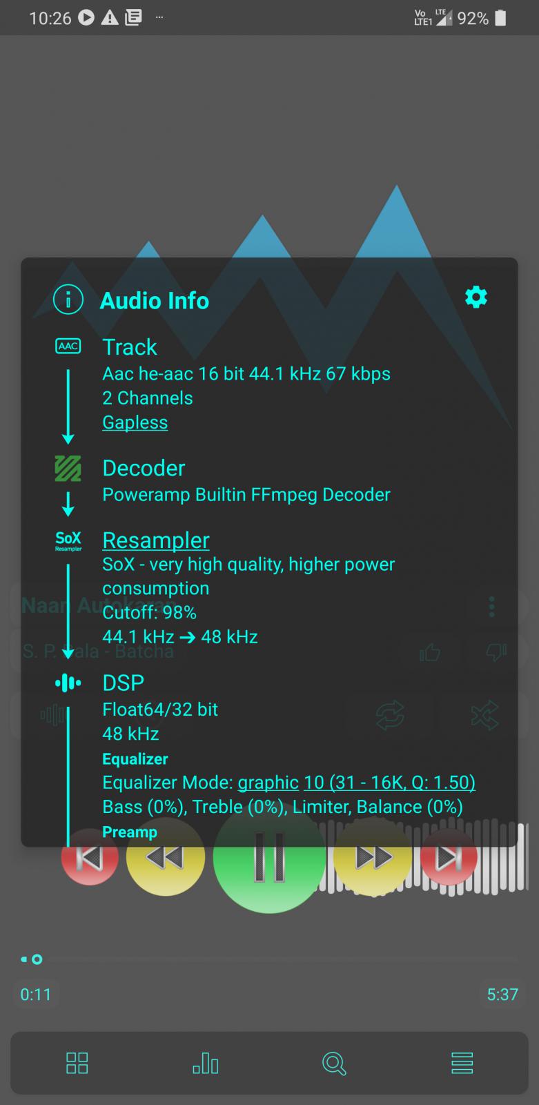

                    I have converted 16 bit depth MP3 file into m4a file using fdkaac by specifying minimum bit depth as 24 bit and maximum bit depth as 32 bit float.
                    After that I have opened the m4a file in android smartphone power amp music player but it is showing as 16 bit.
                    Some of the sites like Hydrogen audio specified that fdkaac encoder cannot convert to m4a greater than 16 bit.
                    May I know how to use fdkaac to encode at 24 bit float or 32 bit float.
                    There is another profile for aac called xheaac but I think that there is no support for it in dbpoweramp.
                    I am providing screen shot of power amp as attachment below.

                      Re: Getting and running latest fdkaac and opusenc encoders for dbpoweramp.
                      m4a aac is bit depth independent when decoding, if a player is showing 16 bit, it means nothing, as it can be decoded to any bit depth (24, 32). Or put another way if you encoded 8 bit, 16, and 32 bit to aac, they would all appear the same to the player. AAC does not have a fixed decoding bit depth, that is why it is normally decoded as 16 bit.
