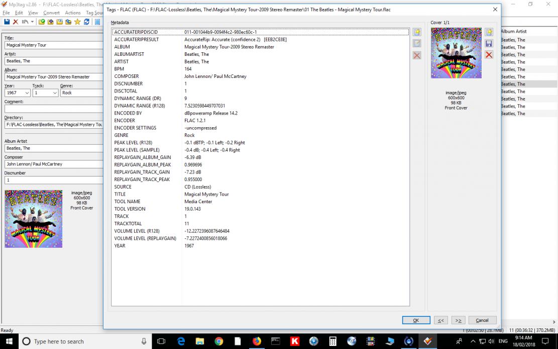

              Here is my info re the same track.
              Is what you are saying that the multi value tag is really only the ; and all that I have done is really just made
              the name of the composer one giant composer separated by a /
              That said should I really just of left it as a ; as it was and found a player that could handle it properly?

                  This would be my approach.
                  Originally posted by shcbris.
                  Just looks like all I've managed to do is to make one giant composer name where multiple composers are involved by using a forward slash to separate the names.
                  Yes, this is how I understand it and your app just displays this one giant composer.
                  If I go to the trouble of using mp3tag to change all the composer and multiple artists files back is "; " ( semicolon + space ) or just a semicolon on its own ";" (with no space).
                  the way to go for both FLAC and ALAC
                  Or just a semicolon on its own ";" with no space
                  Firstly, I work on my flac files only. When I know my flac library is as I want it, then I convert it to other formats e.g. alac, mp3 etc.
                  If you were to convert the flac composer tags in dBpoweramp, you would use '; ' (semi-colon + space), but MP3Tag uses a different multi-value separator to dBpoweramp. For flac files, in MP3Tag the separator is '\\' (backslash + backslash).
                  Also, MP3Tag uses a special action Split field by separator action to convert tags to multi-value tags. See my post no. 28, which describes the 2 actions that you need to do this, which you combine in an action group. Action groups are saved in MP3Tag, so you can re-use them.
                  Make sure you test on a single flac, until you are familiar with what is going on and to confirm the conversion is successful:
                  view the composer in the main MP3Tag window (it should be):
                  composer 1\\composer 2
                  and view the composer in the dBpoweramp windows file explorer context menu option, Edit ID-Tag (it should be):
                  composer 1; composer 2
