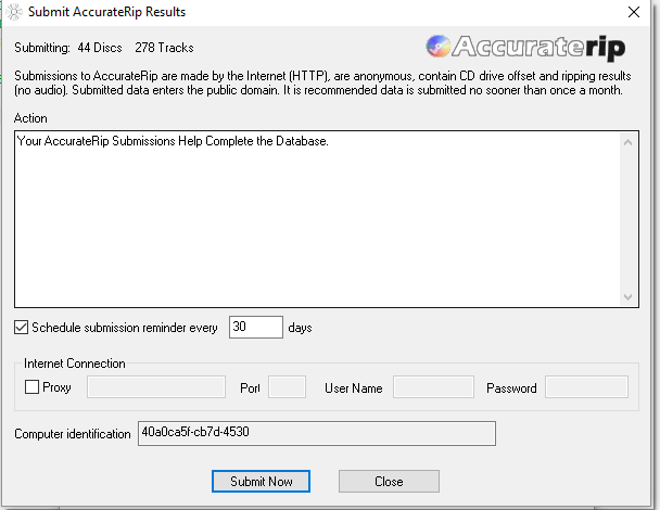

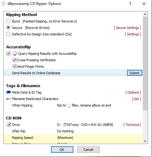

    Hi folks,
    I would like to submit my 'AccurateRip' data to the database, during the course of time; seems like the good-natured thing to do!
    Do I have to perform this task manually each time I rip an individual CD, or is there a setting which will permit this function to work automatically, please?

    Many thanks in advance for any kind assistance offered here.

    Re: Submitting AccurateRip Data (help?)
    It will remind you every 30 days to submit. Or you can submit whenever you want. You submit by clicking on CD Ripper Options, then under the ACCURATERIP section, last item is "Send Results to Online Database". To the right of this, click SUBMIT. Then you'll see a message that it is submitting then done.
    edit: and you don't have to do this every time you rip. It will keep track of all rips since last submission and submit them all at once. But it is probably good to submit more than once a year. That's why the program will remind you every 30 days. I typically submit after a ripping session where I may have ripped 10 or 20 CDs.

      Thanks very much. I would like to contribute/help the system in any way I can. But I can - if I wanted to - perform a submission every time I have finished ripping a CD? I am quite happy to do things as I go along (I tend to work that way). And it only take literally a few seconds. Cheers.
        of course you can.
