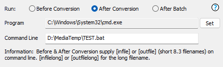

      Thanks for getting back to me - before I start working out how to do any of that, could I ask you to let me know where I've gone wrong with the initial settings, please?

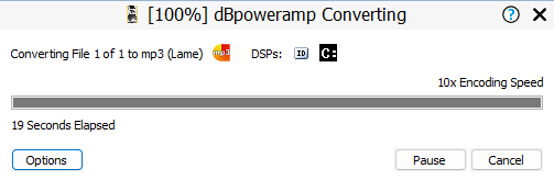

      When I run that, it gets stuck here, counting up the time elapsed indefinitely:

        you would need the command line as:
        /c "c:\yourbatch file.bat"

          Hi Spoon,
          I tried that and had the same issue, seems like something's stopping cmd.exe from running. I tested Powershell which launched fine, so I've been able to do what I wanted in that instead.
