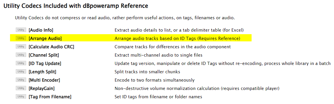

        • 46158
        You can use [Arrange Audio] the latest install has this codec and click the help icon to read about it, choose it as an encoder.

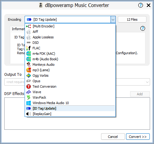

        • JayNYC
          • Feb 2008
          • 63
          Click image for larger version  Name:	2024-10-27_145907.png Views:	0 Size:	34.7 KB ID:	328689
          If I don't see Arrange Audio as an encoder option, what do I need to do?
            • 6186
            Should be included automatically. But in some older versions you had to separately install from here:

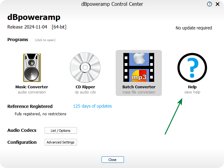

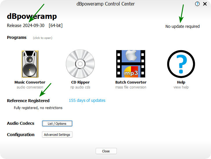

            • JayNYC
              • Feb 2008
              • 63
              I am of the impression I am running the latest version of DBPA Reference. On the linked page above, the Utility Codecs are not downloadable (I don't see a hotlink)

                • 6186
                Hmmm. I have same version as you and I’m not seeing [arrange audio] either.

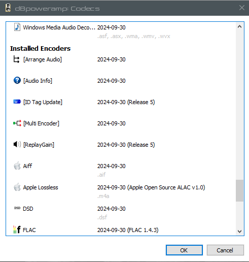

                • GBrown
                  • Oct 2009
                  • 421
                  Working here for me on R2024-09-30 [64-bit]
                    • 6186
                    Where is that screen shot coming from? What do you see in the converter pop up when you see options for “convert to”
                    edit. I see where your list is coming from, audio codecs on control page. Oddly I don’t see the same list as you. Missing arrange audio for example.
                      • 46158
                      It is an issue with the last install, we release a new version on 1ast November to correct this.

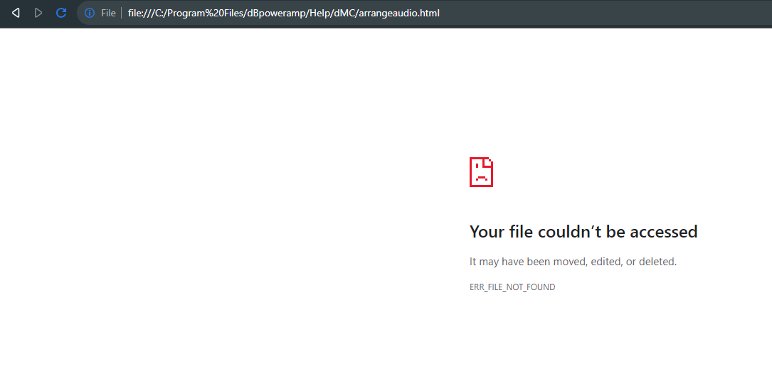

                      • JayNYC
                        • Feb 2008
                        • 63
                        hi again. I've updated to the latest version, but when I click HELP here
                        this is what I get
                        how do I get to read the help page / help file for [Arrange Audio]?
                        thanks
                          • 46158
                          Must be missing from the install that page, will add for next update
