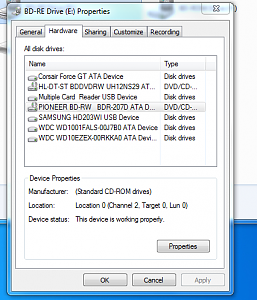

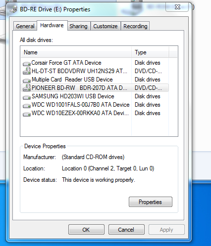

    CD Writer will not burn a CD due to the problem "No CD Writers found" Windows 7 - Checked for updates in dbPower Amp Confiuration and all is up to date. FAQ states older drives may cause the problem, however my drive is less than 2 years old. Drive works with several other burners I use regularly (ImageBurn, James River Media, Windows Media Player). I am attaching the information regarding the CD/DVD/BD Drive. Any suggestions to resolve?
