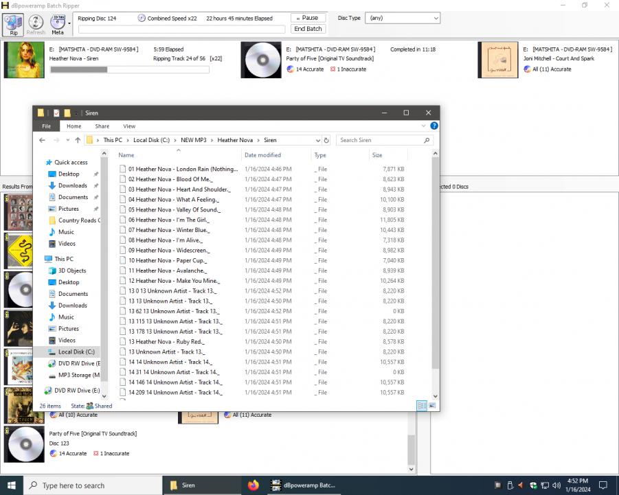

          Seems to have this issue on many CD's when ripping that extra tracks are added, sometimes up to 50 on a 10 track CD. See screenshot if the forum will let me post it. Ideas?

            Re: Problem With Batch Ripper Getting Stuck On A Track....
            Perhaps copy protected, those tracks exist as far as CD ripper is concerned.
              Those CD's play fine with the published number of tracks in other players. This only occurs when using CD Ripper. I checked the one shown in the screenshot in another computer and it plays, rips and copies fine so no obvious copy protection. I have never seen this before with other CD rippers, including the not so good Sony software that came with the drive. So I believe it's an issue with the metadata source or something in CD Ripper....
                Try CD Ripper manually and try using a different drive for that disc.
