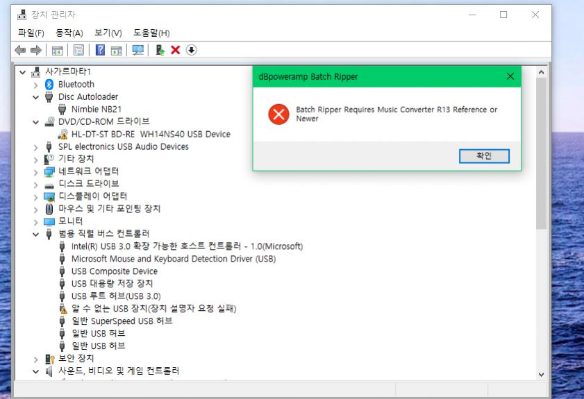

batch ripper requires music converter r13 reference or newer...
  • JANG MINHO
    • Feb 2021
    • 22
    how can i handle this problem?

      Re: batch ripper requires music converter r13 reference or newer...
      Originally posted by JANG MINHO
      [ATTACH=CONFIG]3437[/ATTACH]
      What version are you currently using?
        I don`t know exactly. I have installed two programs in the link below. Install Batch Ripper R5 and Nimbie Batch Ripper Driver v6 https://www.dbpoweramp.com/batch-ripper.htm
          I don`t know exactly. I have installed the program in the link below.Install Batch Ripper R5 and Nimbie Batch Ripper Driver v6
            • 46151
            You need dBpoweramp Reference also (both programs installed to the same location), a trial is on this page:
            dBpoweramp Music Converter - mp3 converter, FLAC, WAV, AAC and Apple Losslesss. Free Download (21 day full trial), start converting today
            • phil14d
              • Dec 2022
              what do you mean "installed in the same location"? I have a purchased copy of dBpoweramp and I have the same error message. Should I have changed the installation default location?
                • 46151
                Install dBpoweramp Reference.
                Then install dBpoweramp Batch Ripper, if you have changed the install location from the default for dBpoweramp Reference you would have to do the same also for batch ripper.
