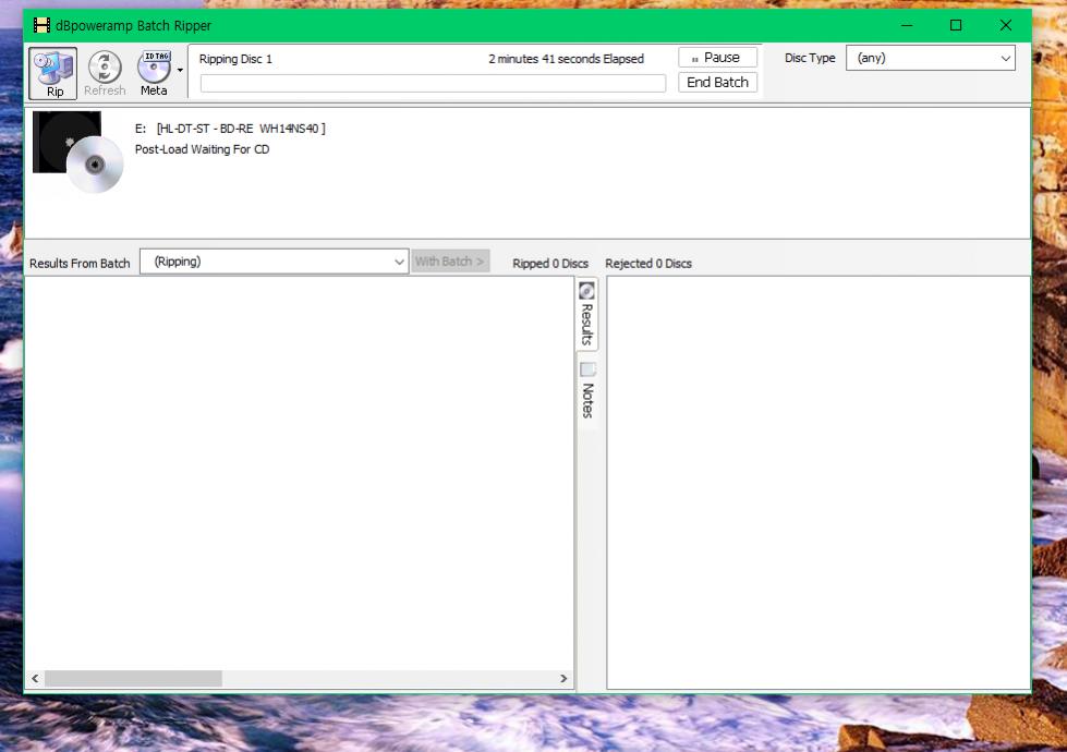

    I use window 10 pro and installed dMC-R17.6-Ref, dBpoweramp-Batch-Ripper, dBpoweramp-Batch-Ripper-Nimbie one after another.
    However, when DBpoweramp-Batch-Ripper is executed, cd does not load. I tested it on two different computers, and both of them don't load cd. I removed the program several times and installed it again, but I couldn't load the CD likewise.

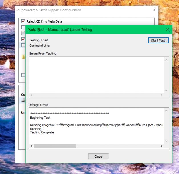

    At first, I suspected Nimbie usb plus, but when I tested it with Nimbie usb plus with QQGetTray, both loading and unloading worked fine. However, the CD ripper loads well and works without any problems.
    The attached captured image is the result of testing loading and unloading in the dBpoweramp-Batch-Ripper Configuration.
    Please, help me solve the problem.

    Re: Cd does not load
    Your drive has been configured as 'Auto Eject - manual load', it needs to be unconfigured the reconfigured to the Nimbie.
