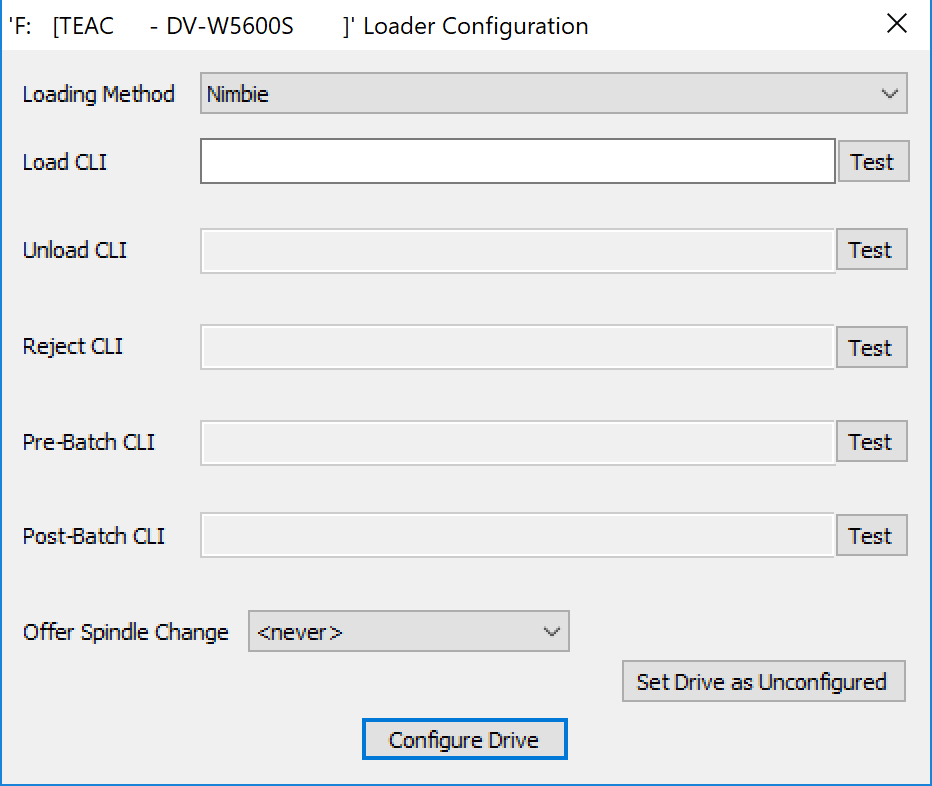

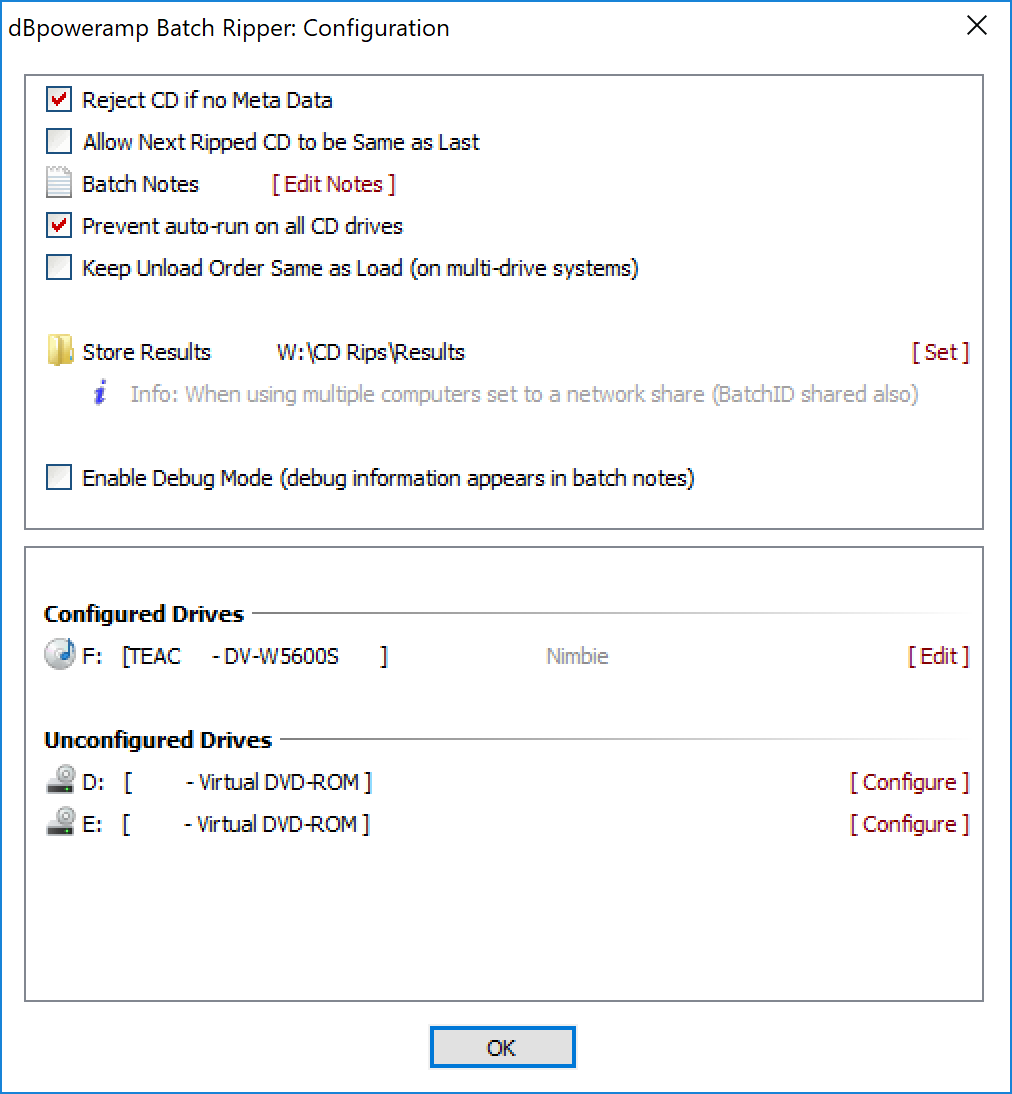

    Everything working great but something I am curious about. The "Unloading CD" and "Loading CD" steps of the batch ripping are taking very long. Way longer than the time to rip a CD. Is this normal? Here is what I have for my Batch Ripper settings:

    On the 2nd image, click 'test' to load and unload manually.

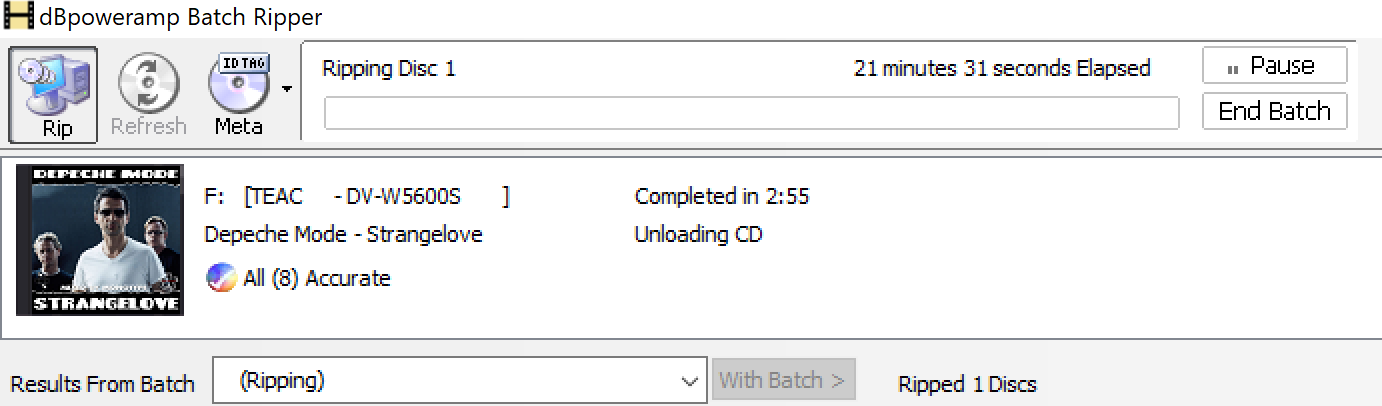

            Here's an example... This CD single is still "processing" after 21 minutes.

              You would have to try Nimbies own software as a test to see how quick it is.
