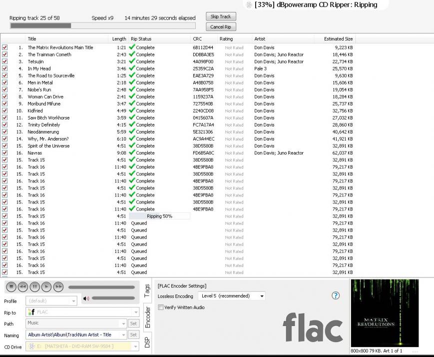

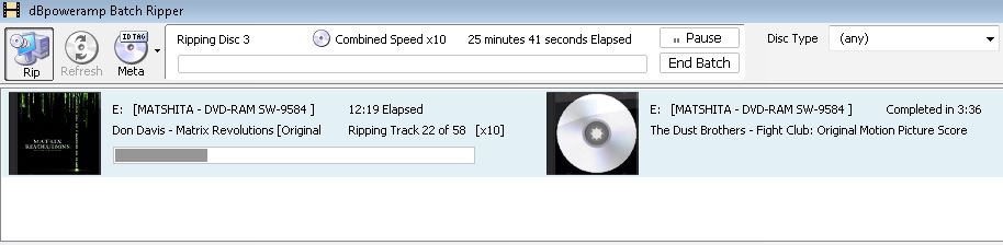

        Re: Batch Ripper ripping 56 tracks with no tags from regular 8-14 track CDs
        Sorry for the wait, tried a bunch of different things, ended up bricking Batch Ripper on my main PC completely, and finally got around to installing it on a build specifically for it in hopes that IEEE 1394 would work better on Windows 7. Sadly the problem still occurs. Got some screenshots for you, as promised:
ID:	294160Click image for larger version
ID:	294161Click image for larger version
