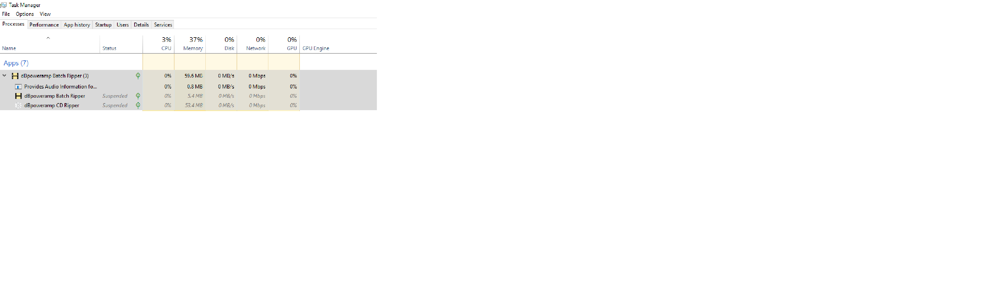

    Set up a Nimbie 21 and all the appropriate files. Running Windows 10. Run Batch ripper and it rips 7 or so tracks and froze. Tried another disk ran though 10 tracks and froze going to second record.
    I attached a log file (Bug File?) for one and a screenshot from task manger. Task Manager shows 3 tasks 2 suspended and besides Batch Ripper, CD ripper.
    I'm not sure what is going on. I uninstalled and reinstalled everything. Also a bit confused with the installation software is the Nimbie QQ software even needed?
    Does CD ripper run with Batch ripper ? Pretty sure I have all the updates in Place. not so sure about configuration

    GetPopupInfo is the other task running when Batch Ripper freezes. Could this be a possible cause of the problem ?
