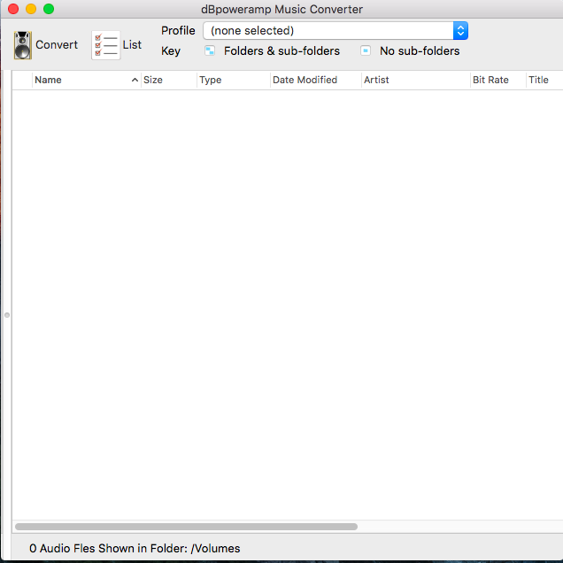

    Please make a picture of what batch converter looks like and post it.
    We've had a similar report before but there was not enough information as we don't get anything resembling this issue on our machines.
    • Mister C
      • 13
      Re: Batch Converter will not display my folders R16.1
Name:	Screen Shot 2017-07-17 at 22.54.26.png
      Thank you for your reply.
      This is the screen i welcomed with on launch of Batch Coverter.

              Sorry it is actually me who has the wrong end of the stick, I thought I was replying to a different thread...
              The issue is the tree to the left has gone, move the mouse to the left side and see if you can pickup the tree resizer bar and drag to the right.
                • 1629
                The left pane appears to have null size for you. This should not be possible, but apparently somehow does happen and not just for you.
                For reference - what exact kind of mac do you have? In particular, what screen size / resolution?
                  • 1629
                  Apparently I cannot recreate this issue on development systems. However I added a safeguard to prevent left pane from becoming null-sized.
                  New beta version posted-
                  This is a bug-fix release addressing reported bugs from R16.1. Current version: R16.2 beta 7 Download: <Released> Changes since R16.1 Fixed Apple AAC encoder bitrate slider glitch CD Ripper can now deal with discs having 98 or 99 tracks. CD Ripper fixed spurious file rename error messages sometimes appearing when
                  Please install and see if it makes the problem go away.
                    Spoon, apologies for my late reply. I've a lot to deal with right now, but your beta release has done the trick for me!
