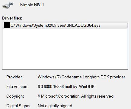

    I have a problem with the Nimbie plus. testing it via CLI, it will open the CD player but it won't load a disc.
    testing through batch ripper config says the command was completed but it does not even try to load anything.
    I have x64 system and uninstalled my dbpoweramp X64 software and installed 32-bit ones.
    I am wondering if the driver is messed up. Is this what I should see in the device manager config?
Name:	nimbie driver.JPG

    Install the applications which came with the nimbie, are they able to control it?
