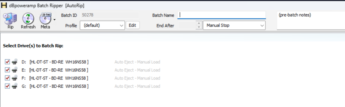

      I tried it out and it does start a rip on launch, however it seems to override the drive configuration. All 4 drives are configured for Nimbies and work, but when I run with --autorip it replaces the configuration to the default "Auto Eject - Manual Load" and so it doesn't work. This configuration replacement persists and I have to open up configuration to change it back to Nimbie.
Name:	autorip overrides nimbie settings.png
      I tried on another machine which has one drive that I had left as unconfigured (the PC's internal drive), and --autorip automatically added that one as a configured drive too.
      Is there any way to --autorip with the specified or last-used config/settings? When I open up Batch Ripper it otherwise does show the last-used config/settings.
        Sorry it does not look like that option does as you want.
