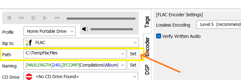

    You click the SET button and navigate to the parent folder you want to use in the lower left of Ripper screen? Don't type in name, click SET and navigate to location to select. See picture:

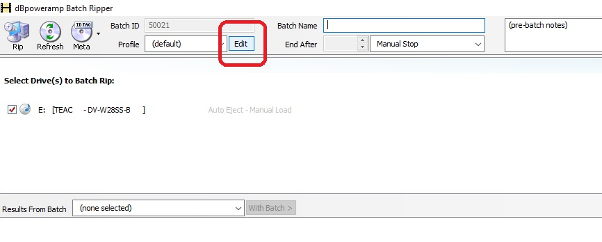

                            In Batch Ripper click the Edit button next to the Profile and a special CD ripper appears to edit settings, you cannot edit in the normal CD Ripper for batch ripper.
                            • Computer Audio
                              • Mar 2013
                              • 25
                              Thank you for your help Spoon.
                              I have done what you say:

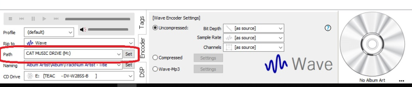

                              And then set the path to where I want the rips to be stored:
                              And the ripped files still end up in my Windows Music Folder.
