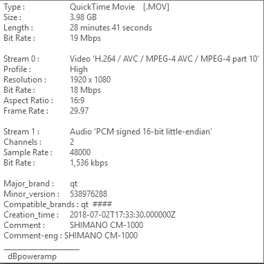

      Really dumb question: How do I verify?
        Re: Referenced QT chapter track not found
        Hold the mouse over the file, the popup should show 'Stream 0:' video and the type.
        • nCubed
          • Jul 2007
          • 13
          Code:
          Stream 0: Video 'H.264 / AVC / MPEG-4 AVC / MPEG-4 part 10'
