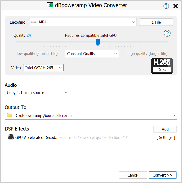

    I'm new to this program and can't get it working with my Intel Arc B580.
    I have the current Intel drivers installed. I can transcode H265 QSV with Handbrake no problems.
    A screenshot of what I'm trying to do has been attached. I've tried it with and without the DSP Effect; same result of it failing with "uknown encoder".
    Can someone help me with figuring out how to get this working for transcoding with QSV?
    Thank you!
    First try removing the DSP effect. Try QSV h264 or QSV AV1 do either of those work?
    I have just tested your exact settings on A380 and it worked perfectly.
    This is likely the issue, try running Video Converter as Administrator (right click on dBpoweramp control centre >> run as administrator >> then choose music converter)

      Sorry for the late response, got distracted for a bit :(
      I tried all of your suggestions:
      Run as administrator - Same error
      Run as administrator and switch to h264 QSV, and again with AV1 QSV - Same error
      There's a new driver available. I'll install and see if that helps and will post back.
      In the meantme, Handbrake is pumping out QSV H265 transcodes with no problem. Which confuses me.

        Just Updated the driver: 32.0.101.6876
        Still getting the error: Unkown encoder 'hevc_qsv'
          Try going back to the older driver version as mentioned on that post.
