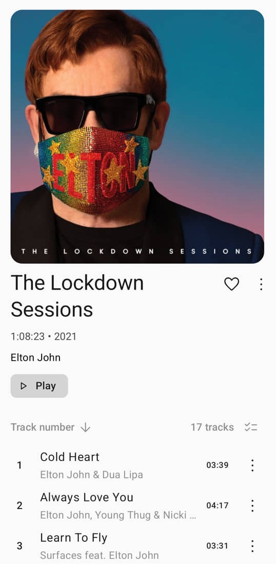

            The most compatible approach to store album and track artists is to use the tags albumartist and artist, but if you want to see the type of artist collaboration (see screenshot below) then you'd need to use:
            artist: Surfaces feat. Elton John
            artists: Surfaces
            artists: Elton John
            artistssort:
            Surfaces
            artistssort: John, Elton
