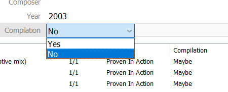

      square since i can only ediit my last post: it's pretty easy to see the difference when you add the compilation field to id tags album overview. as well as check the result (i do recommend pressing refresh since mutli track changes sometimes only change the first track) of changes. or change the value of 1 track (like 1 track set to yes with the others to 1) and see who that impacts things.
      edit:
      wait, you have "compilation" as a free input field it seems, for me it's always "yes/no" in the album overview. even if like you i change it to "maybe" on all tracks the album option only still gives me "yes/no".
Name:	Screenshot 2025-06-08 124647.png
      same in the per track edit mode, setting album artists to various artists makes no difference in that.
      clearing caches makes no difference.
            The difference is probably due to the fact that I use the macOS version and you use the Windows version of PerfectTunes.

                      just updated (windows version) but i can't seem to replicate the behaviour square mentioned: setting compilation to "yes" still writes "yes" instead of 1 (checked with metaflac), and setting it to "no" writes "compilation=no" instead of removing the tag.
                      via "lists and recommendations" however it does correctly find "yes" and "no", suggesting to change it to "1" and "remove tag".
                      to clarify: in "browse by file & folders" mode it's still using yes/no and also writing yes/no instead of 1 or remove tag.
                      am i missing something?
