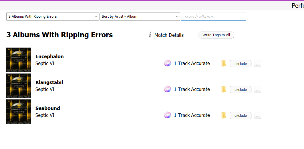

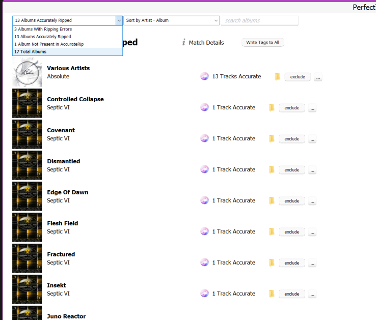

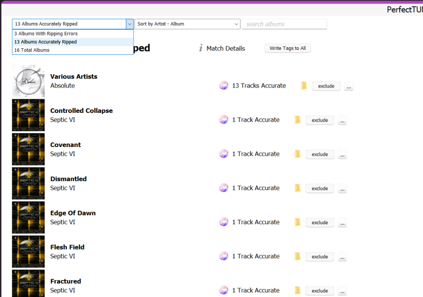

                    i was wondering why perfecttunes accuraterip refuses to handle one compilation as a complete album but instead as a bunch of albums with 1 track

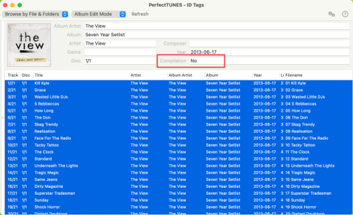

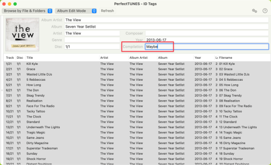

Name:	Screenshot 2025-06-05 055117.png
Name:	Screenshot 2025-06-05 055131.png
                    i tried perfecttunes id tags and to me they seem fine.

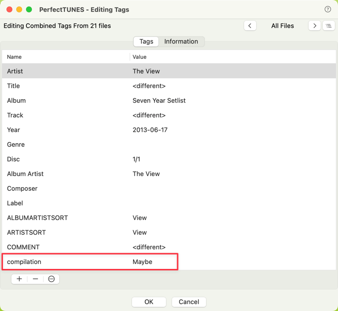

                          Spoon The problem lies in how PerfectTunes translates the values for Compilation in the ID Tags window for display – but doesn't do so when writing tags. The PerfectTunes ID Tag window shows "Yes" when the value for Compilation is "1" or (literally) "Yes". This means that you cannot distinguish between these two cases just by looking at it. Conversely, the window shows "No" when the value for Compilation is "0" or anything else than "1" or "Yes".
                          On the other hand, when you try to modify the Compilation tag, PerfectTunes writes whatever you literally type into the text field: When you enter "1", PerfectTunes writes "1", but when you enter "Yes", PerfectTunes writes "Yes". You can try this yourself: Enter any string into the Compilation text field and have PerfectTunes write the tag. As soon as you reselect the files in the file list, the contents of the text field will change. But if you right-click the files and select "Edit Tags", the upcoming dialog confirms that what got written to the tag is actually the string you typed in.

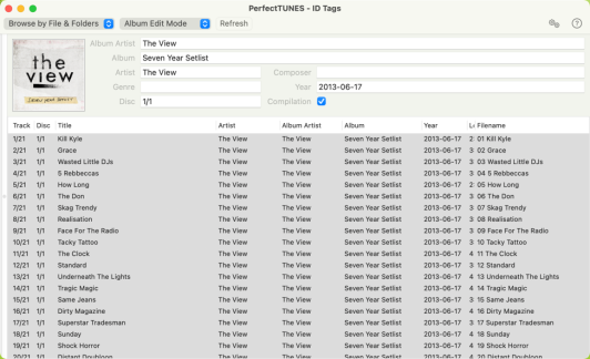

                          Click image for larger version  Name:	compilation_enter.png Views:	0 Size:	109.6 KB ID:	332630 Click image for larger version  Name:	compilation_written.png Views:	0 Size:	122.6 KB ID:	332631
                          I think the most robust solution would be to replace the text field with a checkbox and have PerfectTunes write 1 or 0, respectively – maybe like so (mockup):

                          • vilsen
                            • Jul 2018
                            • 223
                            I like the checkbox solution. However, I think that PerfectTunes should write "1" if checked and nothing at all if unchecked. Reason being some reports that odd players only look at the presence of the compilation tag, ignoring the actual value. So they would take both "1" and "0" (or any other value) as a compilation.
                            Because of that, I've always followed the defacto standard to use the compilation tag only for compilations. I think it makes sense, because no player should need this tag for non-compilations.
                            A minor issue with a checkbox though: How should PerfectTunes handle an existing value of "yes"? To me that's an incorrect value which should not render a tick in the checkbox. But, if you would tick the unticked checkbox, any existing "yes" would be overwritten by "1". Some people might not like their tags being overwritten (even if they are non-standard).
                            Perhaps an alternative grey background colour in the checkbox could indicate "yes" while the normal white background is reserved to indicate "1"? Other ideas? Or is this essentially a non-issue?
