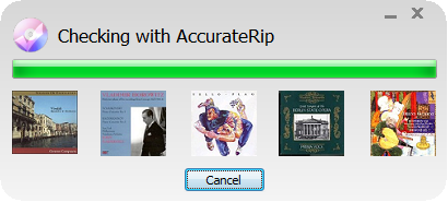

        Re: R1.5 AccurateRip hangs at about 75% of the scan
        BTW here is a screen shot...
