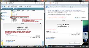

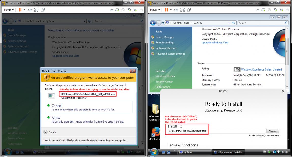

        Some updated information for you: the installer is installing into the wrong folder.
        As you can see, when you run the installer on Vista 64-bit OS it does advise it's running the 64-bit installer file, yet it defaults after to the 32-bit "Program Files (x86)" folder:

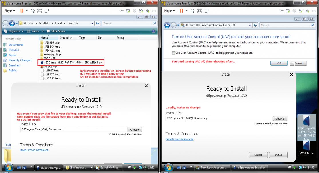

        However, I decided to do the install and see if it actually was the 32-bit version or not... so I when into the "C:\Program Files (x86)\dBpoweramp" folder and double-clicked these EXE files:
        dBConfig.exe
        DMCFileSelector.exe
        MusicConverter.exe
        Then I brought-up Task Manager and went to the Processes tab to see if they had *32 at the end of the filename... and none did!
        So, in short: On Windows Vista, the installer on a 64-bit system is defaulting to the wrong Program Files folder: for some reason it decides to install into "Program Files (x86)", even though it actually does put the 64-bit code in there, and not "Program Files" as it should.
        Hopefully this helps! Might be worth adding a note on the download page to advise on Vista it defaults to the wrong folder, and during install you can manually choose to change the install folder to the correct one.
