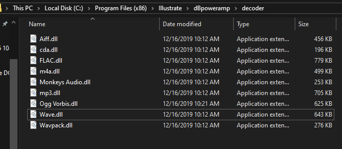

    • ObiouslyBad
      • Dec 2019
      Re: OGG woes Unable to use codec
      Check the file:
      C:\Program Files\dBpoweramp\decoder\Ogg Vorbis.dll
      Exists (or if using 32 bit version in the install folder\decoder)
      It looks like it's there in the decoder folder.
