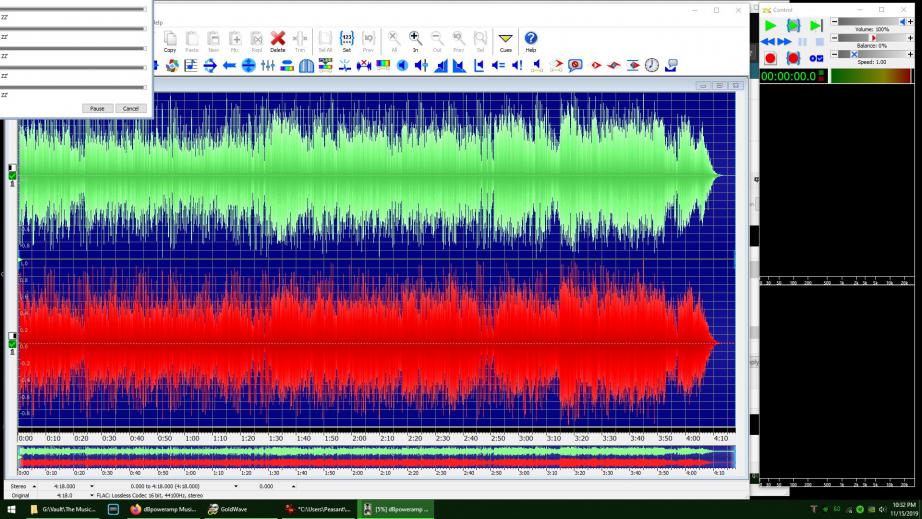

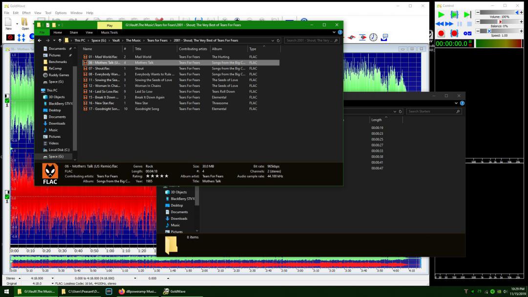

    Folders are overlapping all around the screen. They are a little bigger than a fourth of the screen.
    1920 by 1080.
    DPI is set to 100%. (I know Windows default is annoyingly 150%)
    Only one screen.
    Attached are samples of the folder sizes and how it looks when it goes off screen.

      The image shows you are actually converting, so you add files, the click convert, it is on screen? then add more files and the converting page goes off screen?

        The main converter window, where you select what you're converting to and all the DSPs, stays in one place while adding more files from other folders. As far as I can tell, it tries to be centralized to the folder window it was opened from.
        Once you click Convert >>, that's when the progress windows pops up and is seen like in my screen shot.
