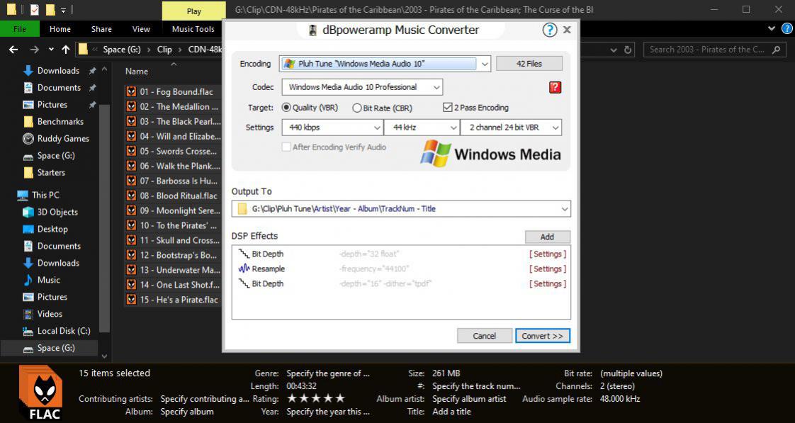

                          So I have no hard proof, but I noticed that the converter window tries to appear centralized in relation to the folder window where it was opened from. (I most always open the converter using the right click option.)
                          The only program I have that might interfere with that is OldNewExplorer. It is used to fix the bad layout of Windows 10 folders.
                          In the attachment you can see the file details are displayed on the bottom of the folder like in Windows 7.
                          Now, I've never had a problem with the converter window in that's shown in the attachment. It's always the next one (conversion progress) that randomly appears mostly out of the screen.
