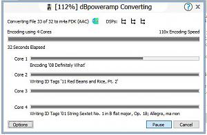

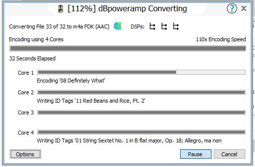

    If I add new files to all 3 source archives, and click "No to All" in the Confirm File Replace dialog box, all new source files are converted/copied as expected. However, in this case, it often happens that one or more FLAC->M4A files will get re-converted when they shouldn't. Sometimes it's one, two, or three extra files. Sometimes, none. Snip 1 shows an example with 1 extra file: core 4 is processing the extra (unchanged) FLAC file. Note that the count at the top says "Converting File 33 of 32" and that the percentage is 112%. The correct number of files to process is 32.

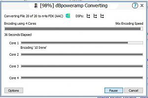

    If I attempt to convert with no new or modified files, but click on "Overwrite" in the Confirm File Replace dialog box, the MP3 source files are sometimes recopied and sometimes undergo a MP3->M4A conversion; meanwhile the M4A source files always undergo a M4A->M4A conversion (instead of a copy), thus lowering their quality. The FLAC->M4A files are not altered. See Snip 2: the Core 1 track is a file from the M4A source archive that is being re-encoded, but should only ever be copied.
