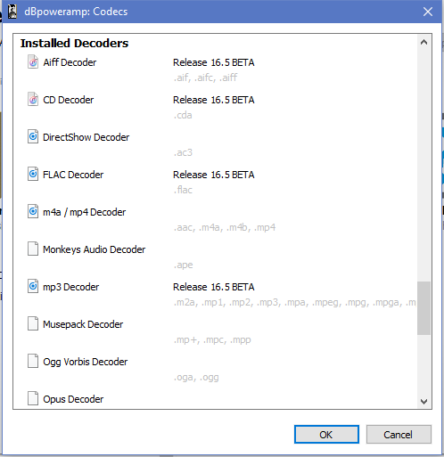

            Re: AC3 to multichannel flac
            It is listed in the image you uploaded:
            DirectShow
            .ac3
            You have to configure the AC3Filter externally, I do not have it installed so cannot say what settings need changing, right now it is decoding as 2 channel.
              DirectShow
              .ac3
              Ok. I wasn't sure about that because there is no further information in the Right column, like for the other codecs.
