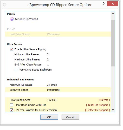

    can't find any reference to C2 Error in CD Ripper settings - please can you direct where to find it?
    • Oggy
      • 704
      Re: New user: Very Slow conversion on 1st ever Conversion from cd to FLAC
      Bottom check box.

          Thanks for the directions Oggy.
          I eventually navigated to the secure option settings and found the C2 checkbox.
          It couldn't have been using the C2 option because the Secure Options was not selected at default setting (ie; off the shelf setting from my download yesterday).
          The Burst ripping method was checked as default (fastest ripping - no error checking).
          Going to try a different cd with the default Burst option and then try the Secure option without C2.
          This should help determine if problem with either the original disc or my laptops DVD/CD drive.
          Luckily I have an external HP CD/DVD drive in case it's my laptop's DVD/CD drive.
                Side note, in case this is not clear. Yes, burst mode is fast, because it's not doing the same checking as a secure rip. best setting is to use "ultrasecure". This will be as fast as burst in the case where the CD is in the AccurateRip (AR) database and you get a match on ripping. If not in AR or not matching, then dbpa will automatically do multiple passes and compare the results to give your greater odds of having a bitperfect rip.
                • Jailhouse
                  • Sep 2016
                  • 388
                  #23
                  Do you enable the vary drive speed option?
                    #24
                    I'm not at home, but I recall that I do NOT enable that.
                    • Oggy
                      • 704
                      #25
                      I've tried it on a very scratched disc, but it seemed to give practically identical results.
