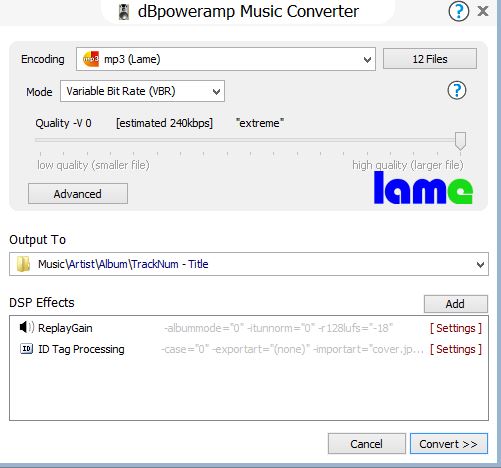

    You're either selecting then right clicking and choosing "convert to" or "dbpa batch converter"
    if convert to, you get the following popup screen: (at the top, under encoder, choose the dropdown and then select mp3(lame). Then set on VBR then use slider for size (-v0, -v1, -v2, etc.)
    If you are right clicking on folder containing tracks then selecting "dbpa batch converter" then you'll get a screen with the files you've selected. Then in upper left you have to click on CONVERT button. Then you'll get the same popup screen as above.
