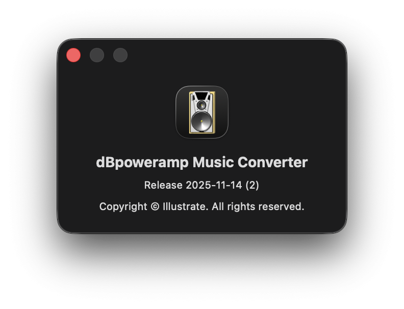

              • 1685
              Please confirm that you've properly upgraded to version 2025-11-14 - about window should look like this:
              I just tested this build again, all works as it should, regression from build 2025-11-12 has been addressed.
