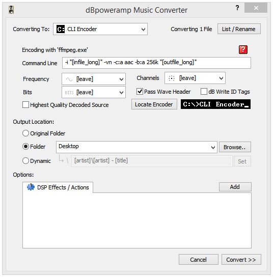

            Try:
            -i "[infile_long]" -vn -c:a aac -b:a 256k "[outfile_long]"
            • Makm
              • Jan 2016
              • 5
              Re: FFmpeg with dBpoweramp?
              Try:
              Nope, still didn't work. :/

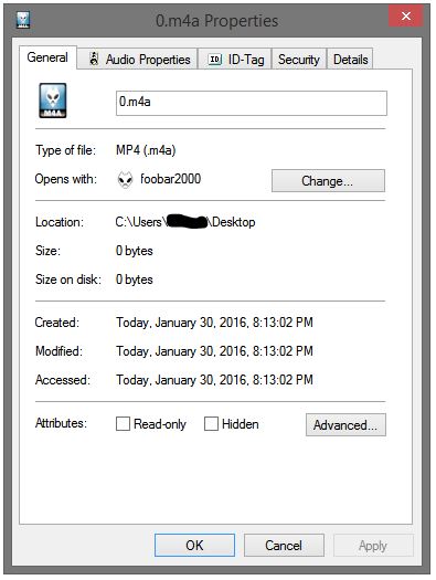

                  File Size Check (core converter exit): 0 bytes Filename: C:\Users\Makm\Desktop\0.m4a
                  I got ffmpeg to work with foobar2000, and here is the command line: -i %s -vn -c:a aac -b:a 256k %d
                  Using it with dbpoweramp would be more convenient for me since I can directly convert from right click menu.
                    It might be failing because dBpoweramp creates a zero byte file, which is needed for the short path name, see if ffmpeg has an option to overwrite existing files.
