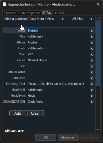

                Just wanted to add that Mp3tag and other tools also don't read it, most likely because it shows up as ORGANIZATION in dbpoweramp.

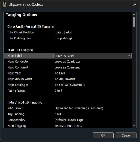

                So to me it still looks like a fault in dbpoweramp, because ORGANIZATION is missing from the pull-down menu.
                  That came from FLAC (which uses Ogg Vorbis tags), the standard for Label is Organisation.
                  You can change that option in dBpoweramp Control Center >> Audio Codecs List/options.
                  " ORGANIZATION Name of the organization producing the track (i.e. the 'record label')"

                    I already checked this setting, but I cannot see how it should solve my problem - there's still no PUBLISHER in the tags after conversion.

                      It would have already been written as Organization when creating the flac file, so you need to map
                      Organization >> Publisher
                      when converting to m4a

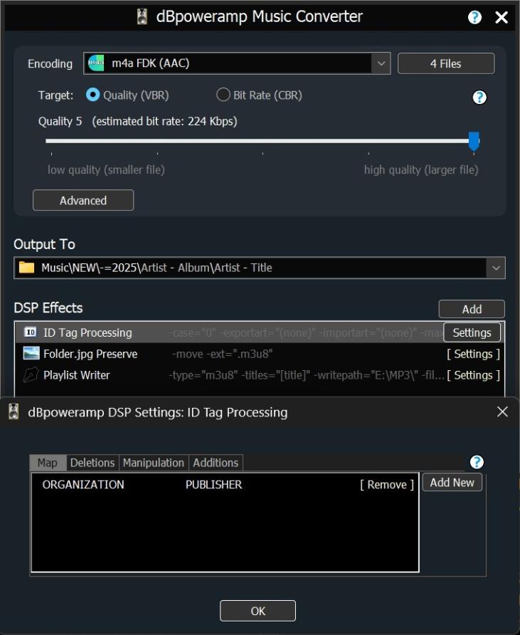

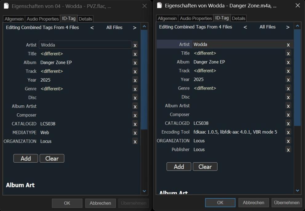

                        This is how I tried:
                        Click image for larger version  Name:	2025-09-29_16h05_39.jpg Views:	0 Size:	64.8 KB ID:	335312
                        And this is the result:
                        Click image for larger version  Name:	2025-09-29_16h08_39.jpg Views:	0 Size:	65.3 KB ID:	335313
                        Could you please provide a step-by-step instruction?
                        I would also like to preserve the MEDIATYPE tags.
                          It mapped the Organization tag to Publisher, you can see it as the last tag. If you no longer want Organization add it to the deletions tab.

                              I've always found the MusicBrainz tag mappings to be a good choice for compatibility, which in this case recommends the use of `LABEL` for FLAC/Vorbis (assuming you're actually storing the record label and not the publisher).
                              It appears that dBpoweramp converts:
                              Code:
                              LABEL -> com.apple.iTunes.@lab
                              PUBLISHER -> com.apple.iTunes.ORGANIZATION
                              Which is why foobar2000 shows it after conversion as ORGANIZATION.
                              Isn't it then a problem with the converter, as it should be mapped to @pub (going from Spoon comment earlier)?
