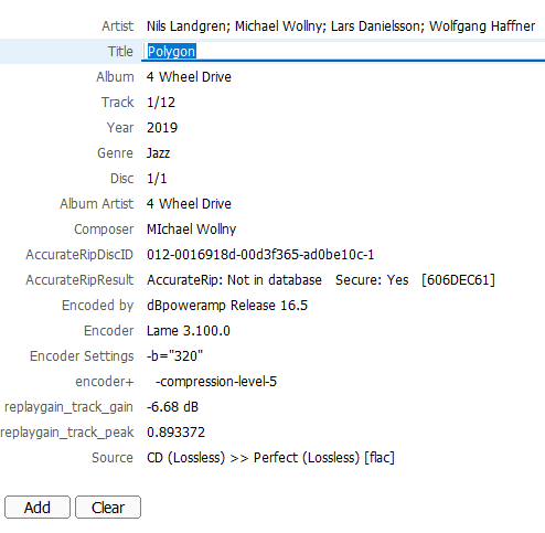

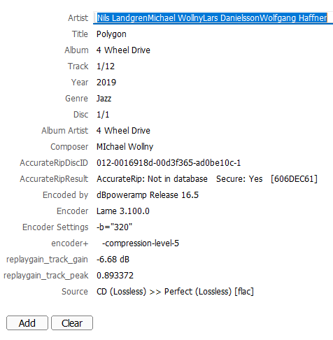

    Hey Spoon,
    there is a bug in two latest Windows versions (2025-7-7 and 2025-7-14). If there are multiple artists, and the input focus is on the correspondig edit field of the dialog 'Edit ID Tags', the delimiters '; ' disappear. As soon as the focus is on a different tag, the delimiters reappear. None the less this makes editing the artist edit field impossible, because as soon as one enters any character, the former content is destroyed and the delimiters are erased.

      Thanks for the report.
      It looks like it saves correctly but fails to show multiple values; if you load tagged file in another app (such as PerfectTUNES) do you see correct multiple values?
        • 1685
        <now released>
        Put in c:\program files\dbpoweramp
        Might have to close Explorer processes with Task Manager to be able to overwrite old dMCShell.dll

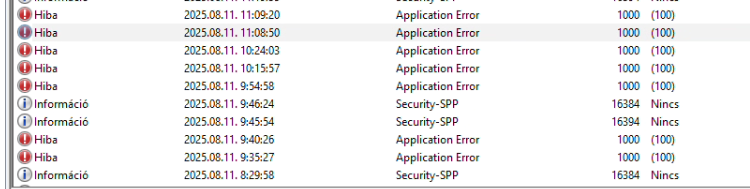

                          Hello for All,
                          I don't know if it's related to the dMCShell.dll updates, but in an installation that has been working flawlessly for several years, we randomly get the following errors, and TotalCMD immediately stops:
                          Name of the application that caused the error: TOTALCMD64.EXE, version: 11.1.0.0, timestamp: 0x00000000
                          Name of the module that caused the error: dMCShell.dll, version: 2025.7.7.1, timestamp: 0x686cdf8c
                          Exception code: 0xc0000005
                          Error location: 0x00000000002aecb7
                          Process ID causing the error: 0x1864
                          Start time of the application causing the error: 0x01dc0a994dd5fa8f
                          Path to the application that caused the error: C:\totalcmd\TOTALCMD64.EXE
                          Path to the module that caused the error: C:\Program Files\dBpoweramp\dMCShell.dll
                          Report ID: 0b6f0d63-9495-4d93-bbd6-a73e7fb702da
                          This occurs randomly when editing ID tags launched from TotalCMD.
                          Today we installed the latest TotalCMD and dBpa, and we'll see.
