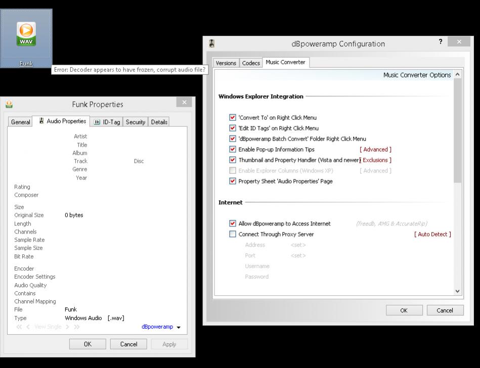

    I started receiving error popups when starting Windows with the heading:
    "provides audio information for dbpoweramp"
    The error popup would appear 2 or 4 times. I then realised that the dBpoweramp popup info (when you hover mouse over audio files) was replaced with an error stating:
    "Error: decoder appears to have frozen, corrupt audio file?"
    and the 'Audio Properties' tab in the file properties (right-click on audio file > Properties) is now empty. The only field which is populated is the 'Original Size' field stating '0 bytes' regardless of which file I try it on. I know these errors are related to the 'Windows Explorer Integration' settings in dBpoweramp Configuration, but rather than simply turn the 'Enable Popup Info Tips' setting off, I want to know if this is going to be fixed properly at all? In my line of work viewing the audio file attributes is very useful and used every day.
    Here's a screen shot showing the error:
Name:	dBpoweramp error.jpg
    Any help regarding the dBpoweramp popup info issue would be awesome though, thanks in advance.

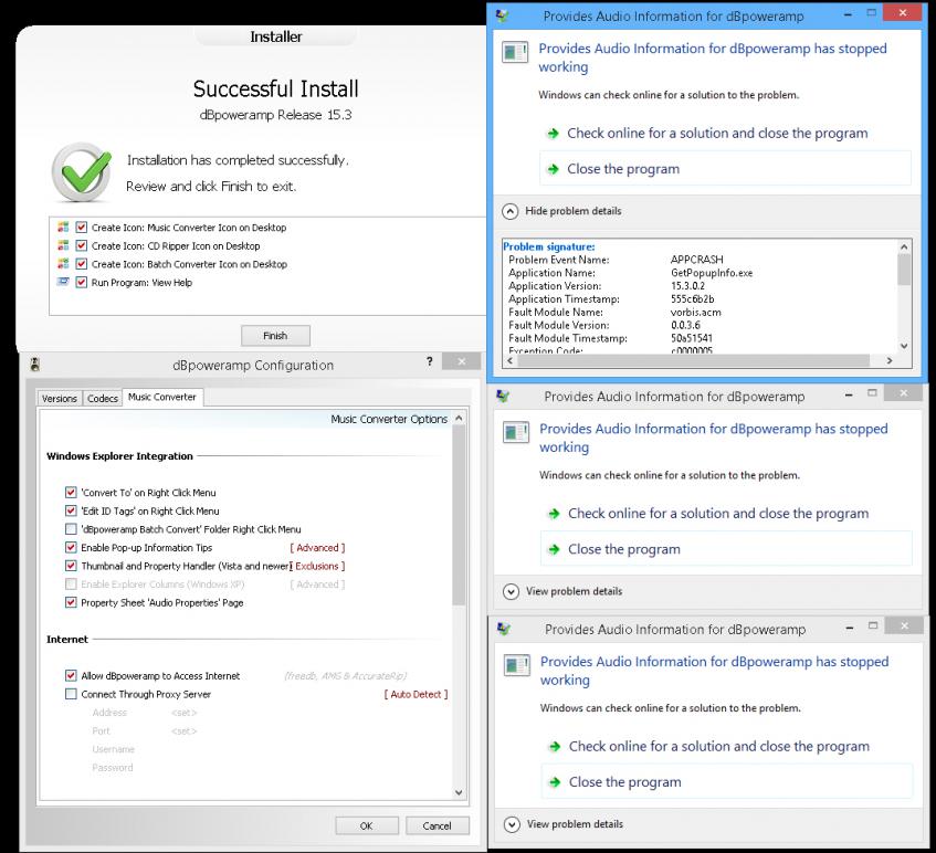

        I just uninstalled dB again, searched the registry and deleted every entry containing 'dbpoweramp' and 'spooninstall'. Rebooted computer. Installed clean copy of 15.3 Ref and immediately got the attached error messages:
        Here's the Windows Error Report data:
        Problem signature:
        Problem Event Name: APPCRASH
        Application Name: GetPopupInfo.exe
        Application Version: 15.3.0.2
        Application Timestamp: 555c6b2b
        Fault Module Name: vorbis.acm
        Fault Module Version: 0.0.3.6
        Fault Module Timestamp: 50a51541
        Exception Code: c0000005
        Exception Offset: 0000000000001f4f
        OS Version: 6.3.9600.2.0.0.256.48
        Locale ID: 3081
        Additional Information 1: 8eb5
        Additional Information 2: 8eb5a186024d65d81afec547bffe0b0d
        Additional Information 3: 649a
        Additional Information 4: 649aed600492e0195a8b34f6fb31c22e
        Read our privacy statement online:
        If the online privacy statement is not available, please read our privacy statement offline:
        C:\Windows\system32\en-US\erofflps.txt
          Re: Popup Info error: "provides audio information for dbpoweramp"
          vorbis.acm
          That is a windows system driver for decoding ogg vorbis within wave files (they do not exist), uninstall it (it was not standard on Windows). Perhaps it came with a media player.

                  Prior to reading your advices I did a generic system search for 'vorbis.acm' and found 2 instances at the following locations:
                  C:\Windows\System32
                  C:\Windows\SysWOW64
                  On reading your post Spoon I felt confident in breaking the file type association of both instances by adding .bak to both filenames so that they became 'vorbis.acm.bak'.
                  Mville, I then checked the Event Viewer and it indeed showed that the faulting vorbis.acm module was located at:
                  C:\Windows\SYSTEM32
                  Having broken the .acm file associations I then opened dBpoweramp Config dialogue and re-enabled 'Enable Pop-up Information Tips' and received no error
                  I opened the 'Audio Properties' tab in File Properties of a .flac file and all the file audio information is showing properly again :D
                  So, it's fixed!
                  Thanks so much for guiding me through to resolution, and thanks Spoon for your program. I've been using it for years, and will continue doing so for years more.

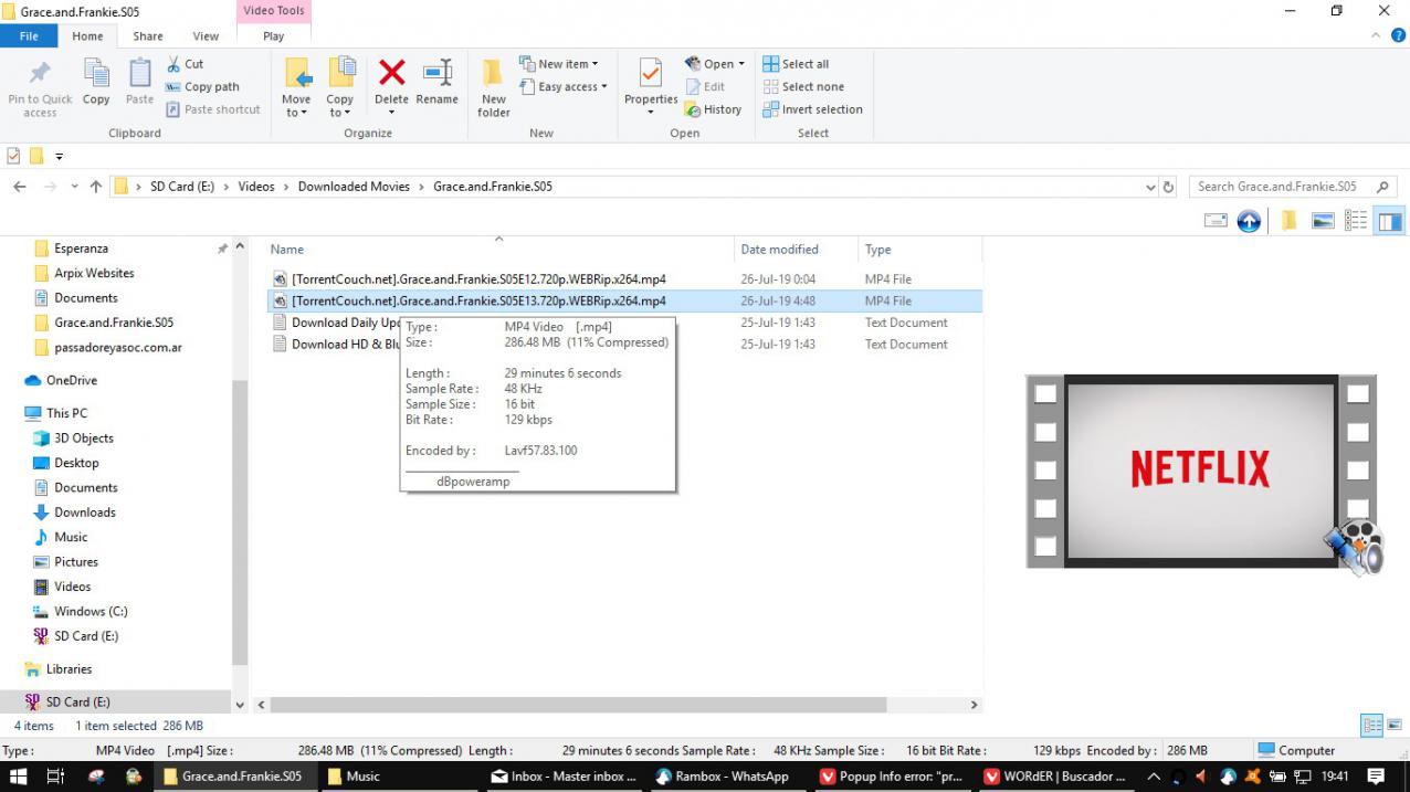

Name:	db capture.jpg
ID:	294121hi! first, thanks a lot for your software, i have been a fan since many years ago... i recently changed from a pc win7 to a laptop win10, and i started to get the same message as the other guy ""Error: decoder appears to have frozen, corrupt audio file?" and the I noticed, that VIDEO mp4 files were freezing upon selecting in explorer.. and I notice the dbpweramp pop up in those files.. but I just want db asocieated with mp3 files... i went to the configuration program and there is a mention for "exclusions" but for "property handler" whatever that means... how can i select which type of files are going to be usiung the pop up feature?? i really love that option, but i dont love the freezing of mp4... thanks in advance!
