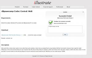

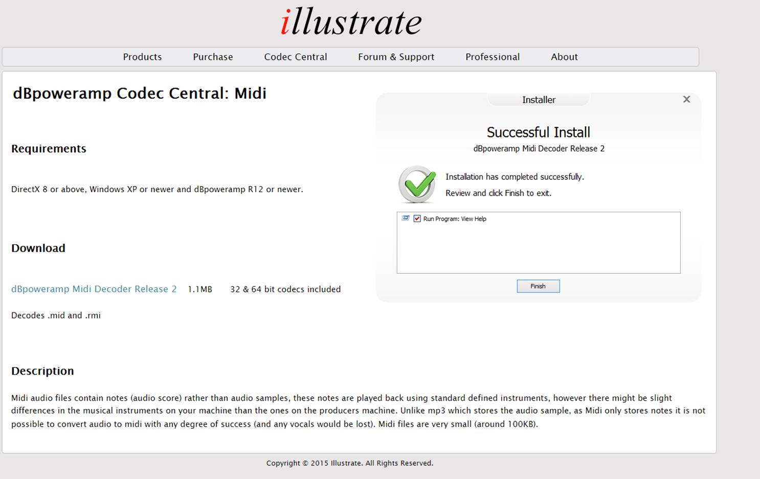

                    maybe this screenshot I took after 'succesfully' installing the codec is what you're looking for:
Name:	screenshot after installing midi codec.jpg
