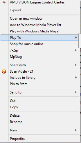

              That's correct - no Convert to ... when i right click a music file this is what i see Click image for larger version
Name:	right click options.PNG
ID:	292951- lots of other options but not what I need
                Re: right click context menu not working
                Windows has a limit of the number of items it will add to the right click menu, and there is no way to decide what appears and what does not. Try removing 2 of the other ones.
                  To do as you suggest, from what I can see it's either fiddling with the registry editor (which I don't want to do as I don't know enough to be fiddling there) or else downloading other apps / utilities (and I have no idea of the quality of the advice offered which suggests these options).
                  it used to work - nothing is changed as far as I am aware. But now I can do nothing at all in that area - it's not just a matter of the right click context menu.
                  Is there any other way I can access it? - I get no joy from attempting to access it through the Illustrate program files, either.
