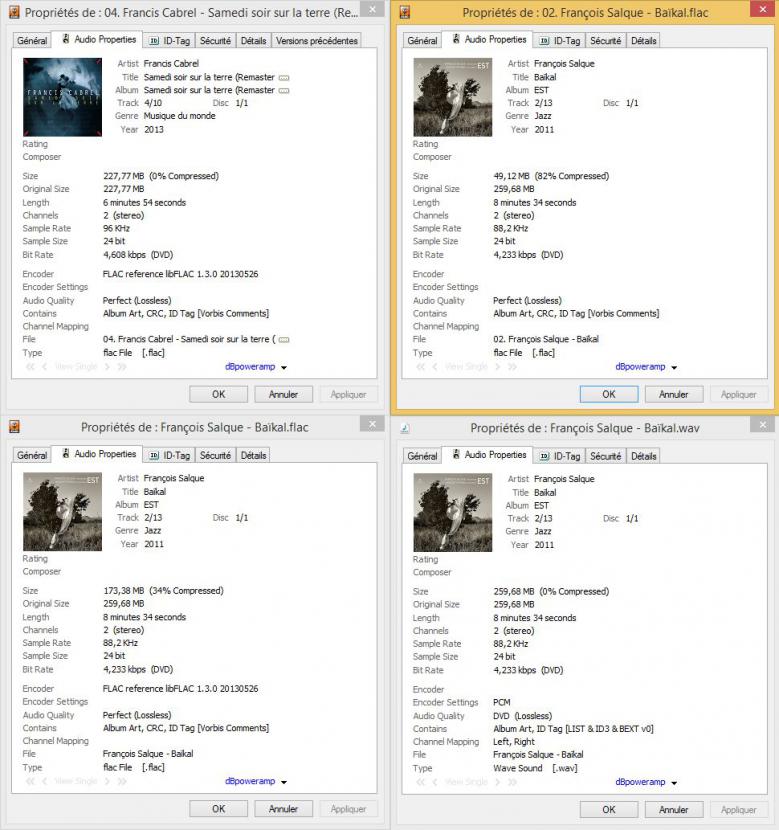

            Hello all,
            I have encountered the same issue, here is an example :
            The first quadrant shows a 24bit uncompressed file that one is correcly uncompressed.
            The 3 others show the "problem", I have started with a file compressed up to 82% ! an orginal file bought from Qobuz : François Salque - EST, I convert it to uncompressed and it goes to 32% not 0, then I convert it to wave and redo the test in the other direction WAV to FLAC and still gets the 32%.

              Re: file wont convert to uncompressed flac after test conversion done on file
              Hello,
              I have encountered the same issue, here is an explanation:
              The first quadrant shows a 24bit correctly uncompressed, great !
              And the 3 others show the issue i got.
                  The file I have been using a regular download from Qobuz : François Salque - EST - For the example: Track Baikal when you download it it comes with a huge compression of 82%.
                  So I use the conversion tool to uncompress it and I still got 32%, I tried to convert it to wave and afterwards convert it back FLAC "uncompressed" and it went back to 32%
                  • Silences
                    • Jan 2012
                    • 27
                    So the question is:
                    Under which sound level does it consider that it is autorised to be compressed?
                    I mean, in the file used here, the music is calm acoustic music with high dynamics therefore some moments are rather low on volume but not digitally silent and, yes, the first 9 seconds contains mainly noise but that's not 32% of the file which is 8mn 35s long.
                    It is in such low volumes that it becomes difficult to get subtle reproduction of nuances in music.
                    And this leads to finally and essentially...why does it still compress when we specifically ask for none ? ;-)
                        Thanks for your answer but..
                        Most of my 24bits succeeded in being "uncompressed", it's just a few of them for which it doesn't work.
                        And I am wondering why?
                        It seems to be related to low level volume portion of music whereunder a certain level it considers to be autorised to compress.
                        Am I wrong?
