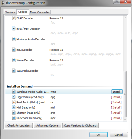

      Re: Unable to install WMA with R15
      I installed R15 and then installed WMA 10 for 64 bit version. Installs fine but dBpoweramp fails when trying to use it.
      Also I need WMA 9.2 for compatibility with my car audio system.
      Windows Media Audio 10 - Release 8 Now Released: http://www.dbpoweramp.com/codec-cent...edia-audio.htm
      R15 does not show it installed, listed as an option for install on demand.Click image for larger version

        • 46229
        The WMA 10 codec has 9.2 as the lossy codec within WMA 10.
        How does WMA 10 fail when using it?

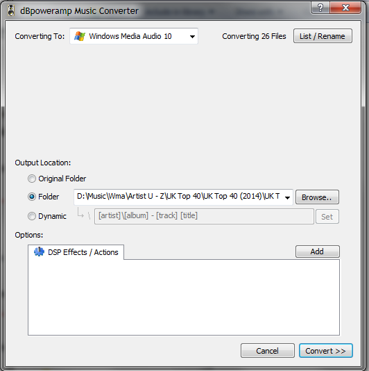

        • kalman8
          • Mar 2014
          • 9
          dBpoweramp 15 does not let you customize any settings for WMA. I attached an image see original post "Capture.png"
          • kalman8
            • Mar 2014
            • 9
