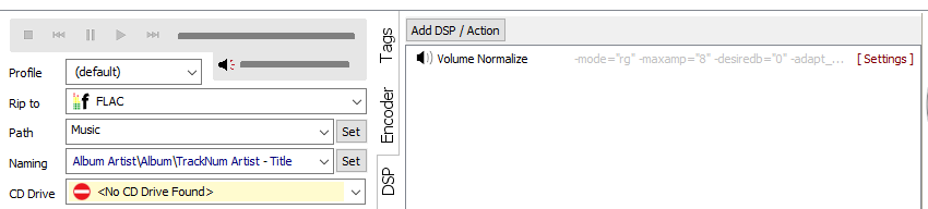

        I can only suggest it would be a configuration issue. You didn't answer the questions from @Spoon. I would guess that given your hardware "works" using the same machine and EAC, that it is very likely a DSP has been applied. A screenshot similar to this with the DSP tab selected can help confirm.

          2) about the DSP section: This part was completely empty. So I pressed the button "Add DSP / Action" and added what I could see in your screenshot. Now it looks exactly like in your screenshot but well, it does not show all settings.
          What to do next? Is it necessary to have these settings in the DSP section? Do I need more settings than shown in the screenshot?
            I just added that DSP there to show something for reference. I usually have this area blank, so there is no DSP applied when I rip my music.

            I wouldn't suggest putting any DSP in that box if you don't know exactly what you are adding. It is better to keep the file unaltered at this stage. It is strange to have anything like this if you have no DSP applied, and if you received a confirmation that your rip passed AccurateRip. Did you try ripping the same CD again to see if it was something abnormal?
