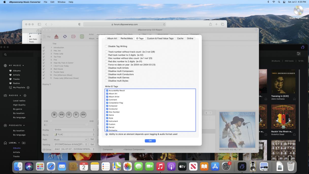

              Is this the area at the top where I should be changing this:
Name:	Screen Shot 2022-07-02 at 4.20.11 PM.jpg
              My discs on multidisciplinary sets are labeled CD01, CD02 etc.
                #67
                Re: Beginner question on dynamic naming
                [ATTACH=CONFIG]3386[/ATTACH]
                that looks correct (you've ticked the Disk Number tag field). Are you saying that multidisk CDs are showing the album name appended with CD01, CD02, etc. If so, there is a setting in ripper options related to adding Disk Number to the end of the album title. I do NOT select that option. I want ALBUM title to be the same for all disks in the multidisk set (no appended disk number in the album title). Instead, I have the metadata field disknumber correct, and for files and folders, each disk is in a separate subfolder under the album subfolder.

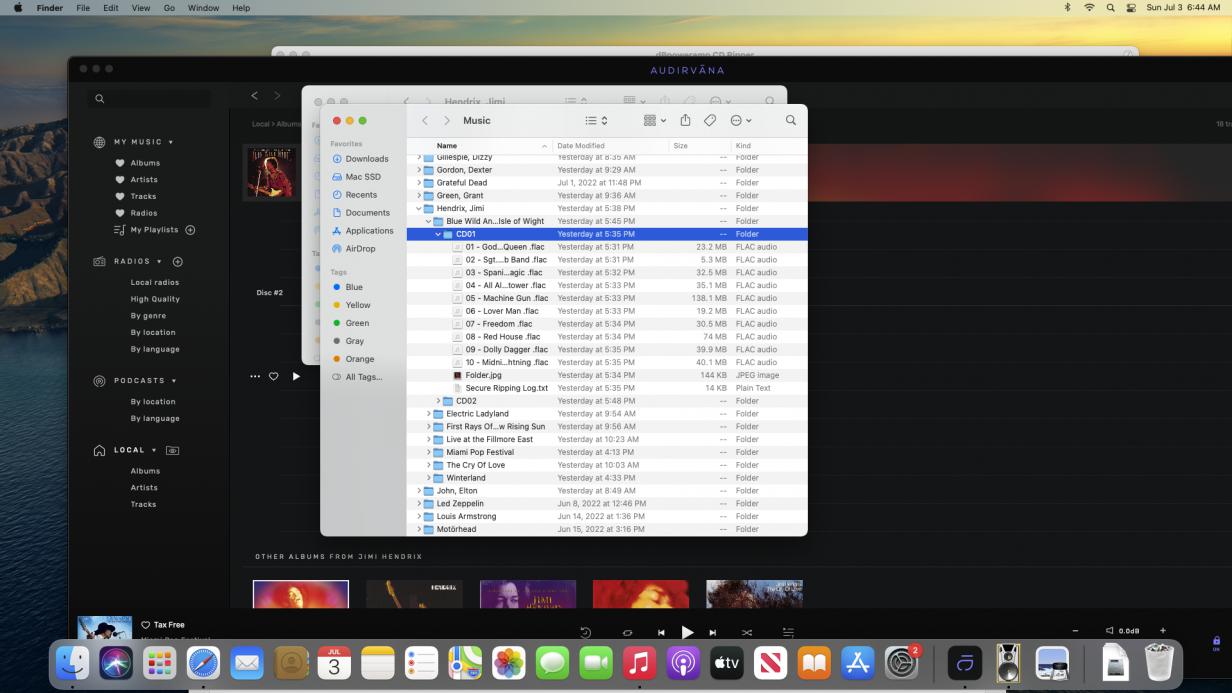

                  No. The disc number is not appended to the album title. Each subfolder is titled CD01, CD02 etc. This is my file structure:
Name:	Screen Shot 2022-07-03 at 6.44.39 AM.jpg
                    #69
                    [ATTACH=CONFIG]3388[/ATTACH]
                    Aha. OK. This looks like everything is working as it should.

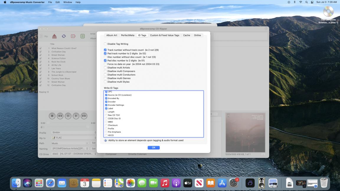

                            Thanks! Are there any other things I need to check in the bottom of the box?
Name:	Screen Shot 2022-07-03 at 7.29.06 AM.jpg
                              #74
                              [ATTACH=CONFIG]3389[/ATTACH]
                              I have all of those that you have not ticked, ticked in my settings. not sure I need them all, but takes little space and I might. HDCD and pre-emphasis would only show up if the CDs you are ripping have those features. (p.s. I don't do anything special in ripping any HDCD disks I have).
