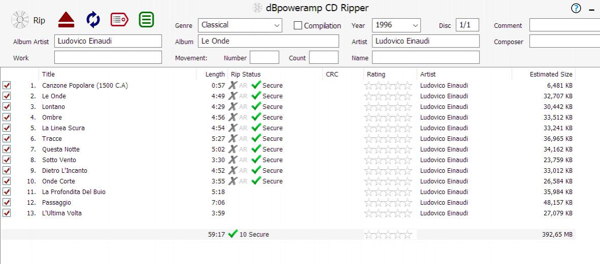

      This is very strange - when I abort the ripping of the disc (with all those errors) and I restart CD Ripper I see the follwing:
      It seems to be just fine. However this is not the behaviour while the CD is ripping, which I described in my first post.

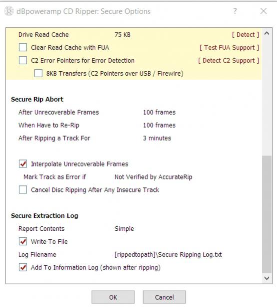

      And these are the options that I have set:
      What options should I set to allow ripping of tracks with Secure Rip which Accurate Rip does not know of?
      I don't see an option to -not- mark tracks as error when Accurate Rip doesn't know about them.
      Thnx!

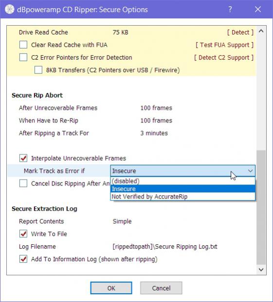

        To the right of "Mark Track as Error if" is a listbox with 3 options (disabled, insecure, not in AccurateRip). Choose disable or insecure.

          Hi Dat Ei,
          Thank you for describing this - it is not visually aparent that there is a LIST BOX with a selection option to the right of the text "Mark track as error if".
          Yes, indeed there is a gap between the text and the option... I didn't "see" it.
          Here, for posterity, is a picture of the option:
          Thank you!

            Agree with you - it's hard to find and could be more obvious. Had to search myself...
